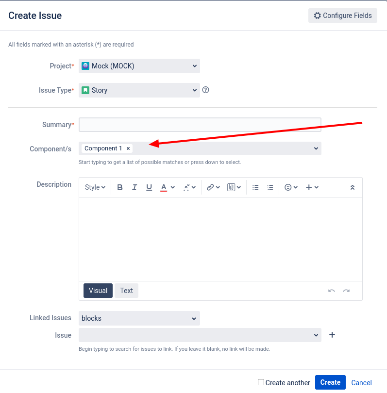

Below is a screenshot of the Behaviour Configuration:-
Below is a test screenshot for your reference:-
1. When the Create dialog is opened, by default, the Component/s field is updated, and the option Component 1 is selected as shown in the screenshot below:-
I hope this helps to solve your question. :-)
