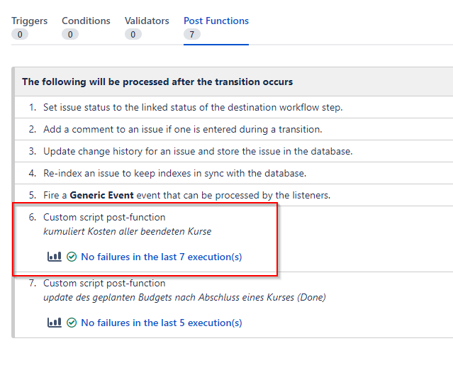

I even tried to shift down the post-function in the list:
Any help or hints appreciated.

thanks for your reply. I was thinking of indexing problems. It was just confusing for me as there is a seperate re-index post-function and I placed my scripted post-function after the re-index.
