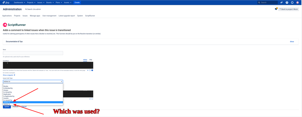

Hi @Diana Gorv
From your description, this doesn't seem to be a problem with ScriptRunner but an error in your configuration.
To proceed, could you please clarify which relates to option did you select?
As shown in the screenshot below, there are two options you can pick from:-
The objective is for the relates to work one way in any one Post-Function configuration.
If you select the first, it may work if the Test issue type transitions. Accordingly, if you are to select the second, it may work when the Bug issue type transitions.
However, if you want it to work when either the Test issue type transitions or the Bug issue type transitions, you will need to configure 2 separate Post-Functions for them; each Post-Function will need to be set to either one of the issue link types accordingly.
I hope this helps to answer your question. :-)

@Ram Kumar Aravindakshan _Adaptavist_ Thank you for the quick response.
I selected the first "relates to", since this post-function is on the "Test" workflow and the intent is for when "Test" issue type transitions to Done only. So a "Bug" issue type can remain in whatever workflow status is on. The idea is, when "Test" is Done, a comment will be added to linked "Bug".
I actually tested using other link names, not just "relates to", and nothing seems to trigger to add a comment to the linked "Bug".
I have also tested by adding the linked "Bug" before transitioning the "Test" issue to Done, because I thought perhaps order of post-functions was incorrect, but still nothing.
Is it possible because they are under 2 different projects, it will not trigger?
