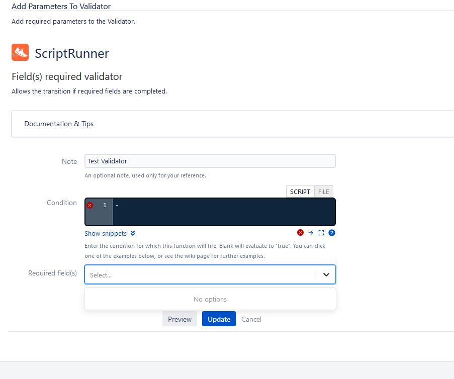

Hi there,
I'm trying to create a field validator during a workflow transition, and when i go to validators, i have the option "Field(s) required validator [ScriptRunner] " but when i try to add a field, is not appearing, not only that field, none of the fields i have are not appearing... is this a bug or what?
I'm running the latest version of Scriptrunner, cuz i just updated it.
I need help, thanks

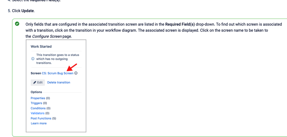

Hi @Viktoria Boiko , have you tried the solution from my answer above? There needs to be a screen for the transition, and only the fields that show up in that screen will show up in the validator.

Yes, there are no options even with the added to the transition screen. I see that there is no such bug in the new version of Scriptrunner and we will update to the new version in 1-2 month with our Jira. But if there is a solution for this version: 6.38.0 that would be good.
I am asking because I can't see this bug: https://productsupport.adaptavist.com/servicedesk/customer/portal/2/SRJSUP-22394
If there is no solution except updating Scriptrunner then it is not a problem, but I would like to know if it exists.
Thanks in advance.
Hi @Heimbrock_ Morgan K-CTR _FAA_ did you check the answer from @Tye Joe Wai ? You need to have the field available on the transition screen...
Hey there @Albert Manuel , just wanted to confirm, do you have any screens associated with the transition where you are trying to add the validator?
As per this documentation , it will only show fields that are associated with the screen shown during the transition, so this may be the reason why nothing is showing up when you try it.
Hi @Albert Manuel did you try to start writing in the field? It quite often uses autocomplete function, so you need to write something.
Yes, still nothing happens...
Same problem for me
same here

Hi @Rajesh Ramankutty there was the answer with the link to the documentation
https://docs.adaptavist.com/sr4js/latest/features/workflows/validators/built-in-validators/field-s-required-validator?_ga=2.67743318.698142823.1664182121-1791370841.1661253031
You need to have the field on the transition screen to be able to configure it as required.
