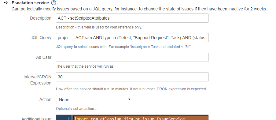

I also included a screenshot of the service definition, with the user information removed.

import com.atlassian.jira.bc.issue.IssueService
import com.atlassian.jira.component.ComponentAccessor
import com.atlassian.jira.ComponentManager
import com.atlassian.jira.issue.CustomFieldManager
import com.atlassian.jira.issue.customfields.manager.OptionsManager
import com.atlassian.jira.issue.Issue
import com.atlassian.jira.issue.IssueInputParameters
import groovy.sql.Sql;
import groovy.time.TimeCategory;
import groovy.transform.CompileStatic;
import groovy.transform.TypeCheckingMode;
import java.lang.Object;
import java.sql.Driver;
import org.apache.log4j.Level;
import org.apache.log4j.Logger;
@groovy.transform.TypeChecked(groovy.transform.TypeCheckingMode.SKIP)
@CompileStatic
void main () {
* Whole bunch of code to determine field values
* Actually perform the updates
if(fValue.toString() != 'null') {
ktField = customFieldManager.getCustomFieldObjectByName("Field1");
optionsManager = ComponentAccessor.getOptionsManager();
fieldConfig = ktField.getRelevantConfig(issue);
option = optionsManager.getOptions(fieldConfig).find { it.value == fValue.toString() };
issueInputParameters.addCustomFieldValue(ktField.id, option.optionId as String)
issueInputParameters.setSkipScreenCheck(true)
issueInputParameters.addCustomFieldValue(cfPI.id, priorityIndex.toString());
IssueService issueService = ComponentAccessor.getComponent(IssueService);
user = ComponentAccessor.getJiraAuthenticationContext().loggedInUser;
update = issueService.validateUpdate(user, issue.id, issueInputParameters);
if (update.isValid()) {
issueService.update(user, update, com.atlassian.jira.event.type.EventDispatchOption.DO_NOT_DISPATCH, true);
main();
