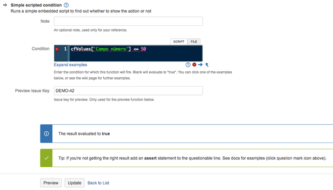

i got a state of an Issue which has two outgoing transitions (Transition A & Transition B). Regarding the value of a custom field (Type: number field) I want either Transition A or Transition B shown if the value is 50 or smaller. My try was using Scriptrunners Simple scripted condition:
cfValues['custom field'].values <= '50'

Can you try with this:
cfValues['custom field'] <= 50

thanks for the fast reply. I've changed the code as you suggested and got the following error:
[Static type checking] - Cannot find matching method java.lang.Object#compareTo(int). Please check if the declared type is right and if the method exists. @ line 1, column 1.
Probably got a problem with the data type?

Hi @Christian Sander
Yes, can you check the value in the custom field? You can also test (preview) the script when configuring the condition to validate it.

Hi Carlos,
Thank you for the tips. It's working fine.
Cheers Christian
