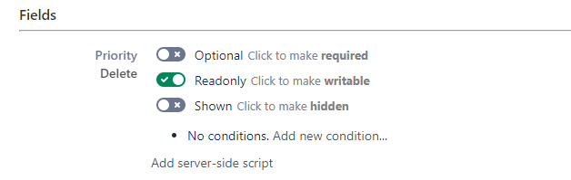

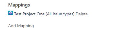

I have two projects, Project A and Project B (Completely fresh projects). I created a behaviour which is mapped to Project A. All the behaviour does is set the priority field as read-only.

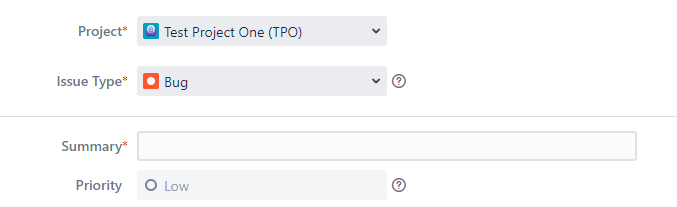

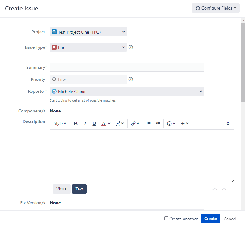

When going to create the issue on Project A, the 'priority' field is set to read-only, which is what I want to happen.

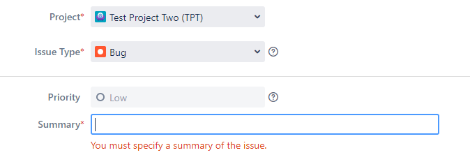

When I switch to Project B, the field is not set as read-only, however after clicking create it is set to read-only when it shouldn't be. It seems that it's carrying the behaviour over from Project A.

Based on what I observed on the screenshot you attached, I noticed you only mapping the Behaviour to "Test Project One" Only.
This might be the reason read-only is not working on the project TPT Priority's field.
If you wish to apply the Behaviour to another project, could you please map the Behaviour to the other project/ select All Project while add mapping and see if it works?

  • Create a Behaviour which is mapped to Project One (All issue types)
  • Add the field priority and set it as read-only
  • Go to Project One.
  • Click "Create" from the Jira menu bar.
  • Select Project One and select an issue-type that has the priority field.
  • Check if it's read-only. (It should be read-only as intended)
  • Change to Project Two and to an issue-type that has the priority field.
  • Click on "Create" and the priority field will become read-only.
