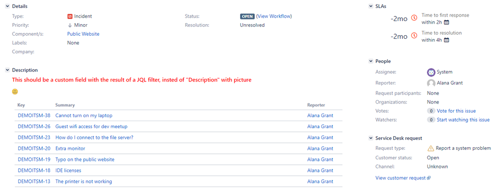

Hello!
We have a case, need an opportunity to easily get results of dynamic JQL-filter just in issue.
For example, the field where we can see links to unresolved issues of current reporter.
On my screen - it is "Description".
The field should contain results of JQL-filter or Groovy script that will take values from the tasks, for example, || reporter = "current reporter" and resolution = unresolved ||image.png
The filter will be global for the field, but dynamic - in relation to the values from the issue.
This is just an example for explaining the problem.
The overall goal is to get a tool that allows you to add fields with filter results to issues.
Is it possible to make it using ScriptRunner`s custom fields?
Or maybe you know any another solutions? Maybe plugins?
Thanks for help!

Alexander Bondarev
February 27, 2019
Hi! Thank you for answer!
The guys from the Scriptrunner`s support team helped me to display the results of the JQL-filter in a custom field in a table form.
But I don`t know how using JQL-functions get issues of "reporter of current issue", not "currentUser()"?
The main task - Agent of service desk during processing should see all unresolved tasks from the current reporter - This will help speed up their decision or identify duplicate tasks.
