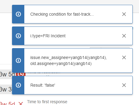

I need to force a transition when an issue is assigned (via the Assign button), but only if it was previously unassigned. Following the documentation about Fast-track transition an issue,
https://scriptrunner.adaptavist.com/latest/jira/builtin-scripts.html#_fast_track_transition_an_issue
Then building on the example given in the Script Listeners console, I created a listener on the Issue Assigned event, on my project, using this condition:
import com.onresolve.scriptrunner.runner.util.UserMessageUtil
UserMessageUtil.info('Checking condition for fast-track...')
UserMessageUtil.info("i.type=" + issue.issueType.name)
UserMessageUtil.info("issue.new_assignee=" + issue.assignee + ", old.assignee=" + originalIssue.assignee)
// Our issue types + Assignee changed but only if previously was unassigned
def result = (issue.issueType.name in ["FRI Incident", "FRI Service Request"] && (issue.assignee != originalIssue.assignee) && (originalIssue.assignee == null))
UserMessageUtil.info("Result: '" + result + "'")
return result
However, when I open an unassigned issue (which matches the issue type condition) and assign it, the listener is triggered, but the condition always returns false because the value of originlaIssue.assignee apparently is set to the new assignee - see screenshot.
Seems like a bug in the implementation, or a bug in the example.
Anyone?
Roland Holban (Adaptavist)
May 22, 2018
This condition will return true if previous user was Unassigned and current user is not Unassigned. You can add code to check for issue type as well

Amir Katz (Outseer)
May 22, 2018
I've just noticed that the example that I used from the Script Listeners console (Assignee Changed) is tagged as Workflow functions only
I assume that's the reason why my code does not work as a condition for a stand-alone listener.
I am now using Roland's answer above and it works.
