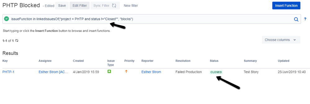

OK, I marked this as accepted, and it seemed to work for one project's set of searches. I just tried to create a new set for a different project, though, and it's not quite working correctly.
I would expect that using status != Closed in the search would return only issues where the status isn't Closed (we can't use Resolution, as Closed is not our final status, so the resolution is not set at that point.) That clearly isn't the case, though, as you can see from this screenshot.
Is there anything obvious I'm doing wrong here, or is it a bug in the plugin? Or is resolution really the only bit of JQL that can be used in linkedIssuesOf?

This inner query applies only to the linked issues.
This says "give me all issues that are linked to open issues in the PHTP projects with the "blocks" link type.
If you want to exclude non-closed issues in the final list, you need to add a "and status != closed" outside of the issue query.
so perhaps:
status !=closed and issueFunction in linkedIssuesOf("project = PHTP and status != closed", "blocks")

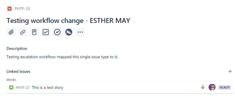

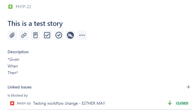

Say I have two tickets, PHTP-10 and PHTP-22. They are linked; PHTP-10 blocks PHTP-22:
We're trying to create quick filters in boards that will allow a project manager to display only tickets that are blockers and only tickets that are blocked. However, our volume is too high for them to update the links on every ticket when the status changes. So because PHTP-10 is Closed, even though the ticket link still indicates that PHTP-22 is blocked by PHTP-10, it's not really blocked anymore.
