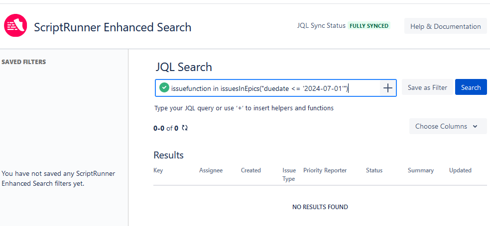

@Trudy P Claspill
still no luck
Interestingly, if I try and add the same with the helper, it shows a partial result (there should be more) but when I added that to the list, it still results in 0.

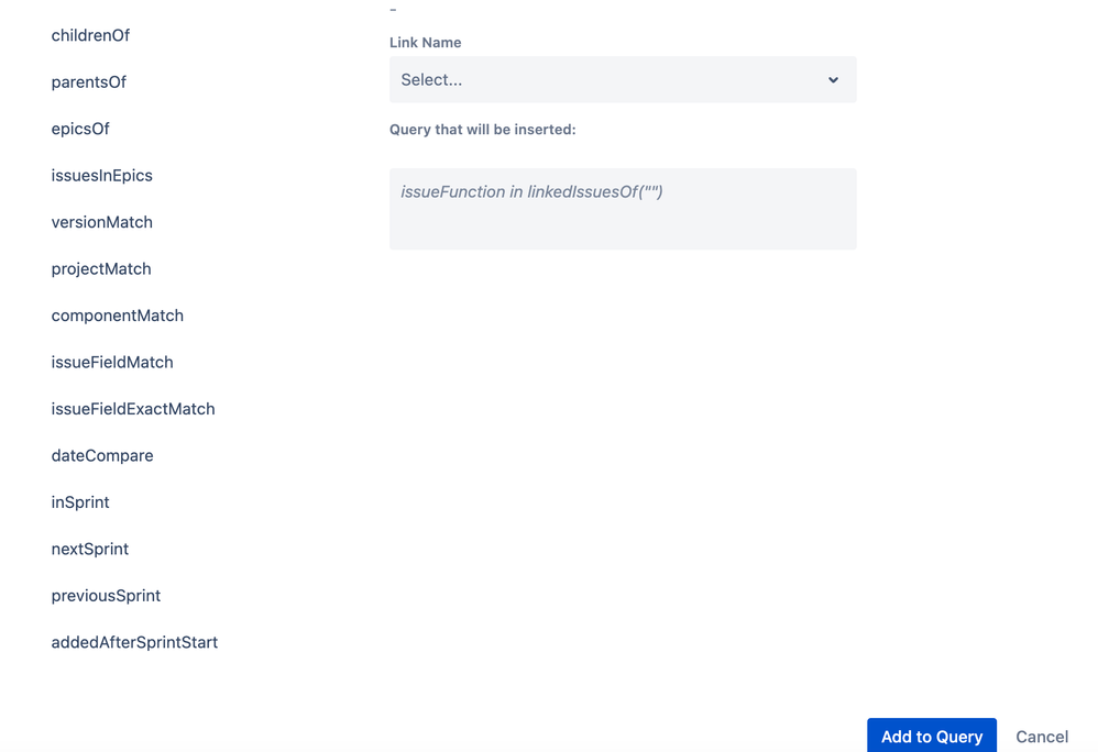

I have had some oddities with the Enhanced Search sporadically where I have typed in the JQL directly on the screen but it says the JQL is invalid or gives an odd result. I've never figured out why.
But if I use the helper to create the same JQL, then it works.
When using the helper there is a button at the bottom right corner of the helper pop up to add the content of the helper to the query. Have you used that? The pop-up is too big to display entirely on my screen so I have to scroll down to see that button.

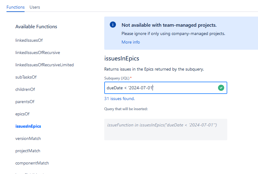

Yes, I have used the helper that way. Any idea what that "Team managed projects" notification is that is showing up? Clicking on more info just gets me to the blogs, and I don't know how to see if I'm hitting that "wall" or not.

In Jira Cloud there are two over-arching project types - Company Managed and Team Managed. You can find out which type your project is by going to the View All Projects page under the Projects menu, finding your project in the list and looking at the Type column.
The query within the helper dialog gives you the same results as if you ran the identical query (duedate < '2024-07-10') in the regular issue search screen. It is not yet applying any other criteria to it related to the function that you want to use. You can click on the link to see the actual issues it has found based on that portion of the query.
Those results will include all issues of all types in all projects (to which you have access) that match the subquery.
When you then insert that subquery into the function, that applies another layer of criteria. In the case of the issuesInEpics function, you are getting the Epics that match the subquery first, and then getting all the child issues in those Epics as the final results.
However, if any of those Epics are in Team Managed projects, they and their child issues will be excluded.
If you think you have an Epic that matches the subquery, that has child issues that should be in the results set, and that Epic (and the child issues) are not in a Team Managed project, can you share screen images of that Epic showing the due date and the child issues?

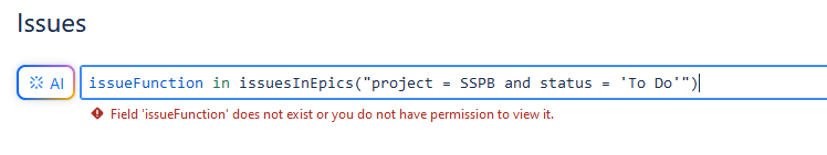

Yes, I have. But the documentation there is misleading/incorrect. If you read the page it clearly says "You can use ScriptRunner JQL functions anywhere you are able to use Jira JQL functions" So I go to issue search, where I can use Jira JQL, copy the code form their example on that very page that reads
  • Use issuesInEpic to find all stories for open epics in a project, and then look specifically at the status of issues, such as ‘in progress.’
And I get
If I go to `ScriptRunner Enhanced Search` as suggested by Trudy above, you can see my problem, with the helper showing 31 results but actually running it returning 0.
