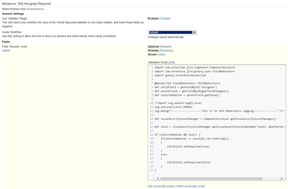

Here's my behaviour code.
import com.atlassian.jira.component.ComponentAccessor
import com.onresolve.jira.groovy.user.FieldBehaviours
import groovy.transform.BaseScript
@BaseScript FieldBehaviours fieldBehaviours
def childField = getFieldById("assignee")
def parentField = getFieldById(getFieldChanged())
def selectedOption = parentField.getValue()
/*import org.apache.log4j.Level
log.setLevel(Level.DEBUG)
log.debug("--------------------This is to test Behaviours Logging----------------")*/
def issueSecurityLevelManager = ComponentAccessor.getIssueSecurityLevelManager()
def level = issueSecurityLevelManager.getIssueSecurityLevelsByName("Autor, Bearbeiter & Beobachter")
if (selectedOption && level) {
    if(selectedOption == level[0].id?.toString())
        childField.setRequired(true)
    else
        childField.setRequired(false)

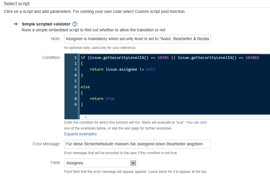

Yes, you understood it correctly. I think the problem is, that the assignee field is never truly empty. It's either set to a specific user, unassigned or automatic. This is why I needed a workflow validator. See below.
if (issue.getSecurityLevelId() == 10305 || issue.getSecurityLevelId() == 10308)
    return issue.assignee != null
else
    return true
The behaviour is set to all projects and all issue types.

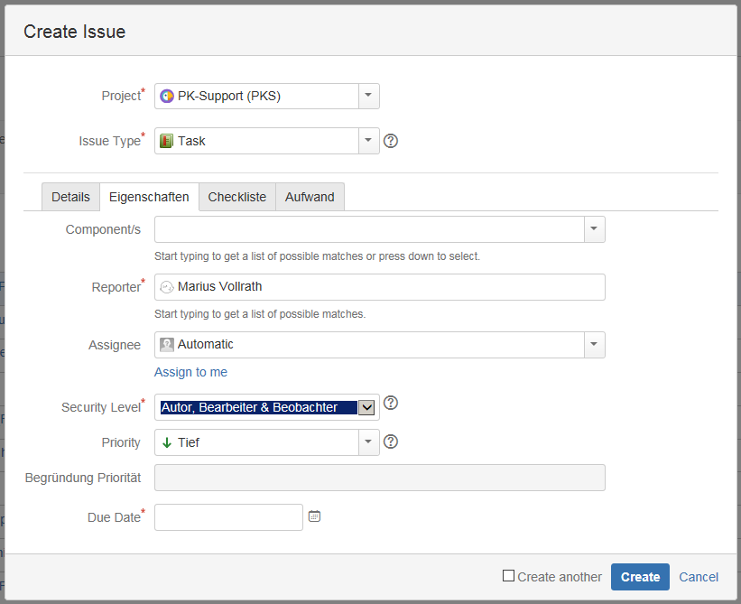

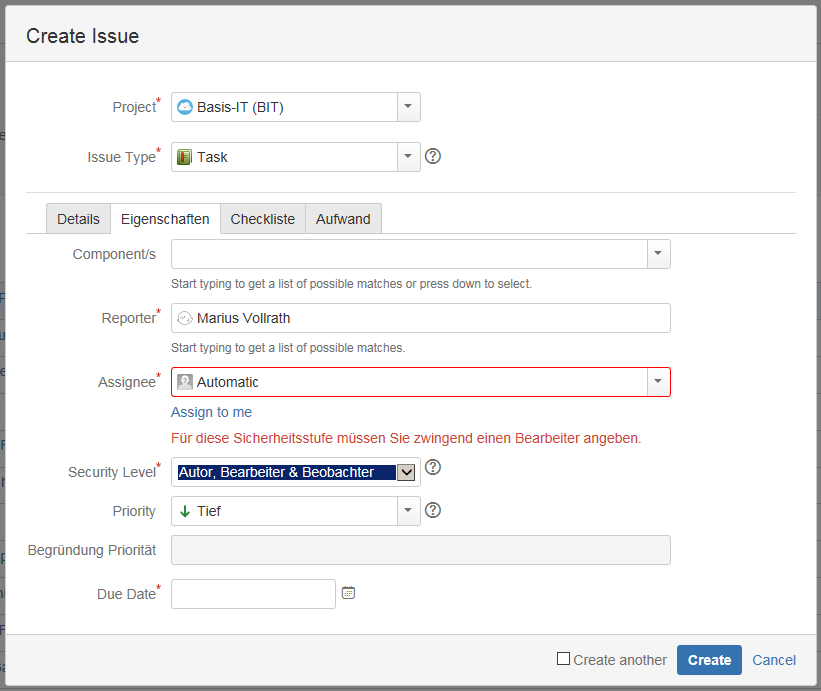

Reason:
I created an issue with our restricted security level that requires an assignee. I assigned the issue to me on creation. After that, I was able to successfully edit the issue and set the assignee to unassigned. Since I did not change the security level, the behaviour did not get triggered and thus did not prevent the update action. This is why a second behaviour on the assignee field is necessary.
Now it should be impossible to bypass this requirement :) Thanks for your help!
The only issue that remains now is that it only works for one project :/ Even with explicit mapping to another project and issue type, it does not get executed when creating such an issue..
Working Project:
Not working project:
I know that even with the same name, these security levels have different IDs. But since I'm using "getIssueSecurityLevelsByName", I thought that wouldn't matter.
