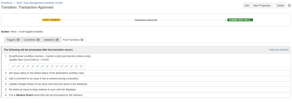

I would like to add 1 month to a custom date field (Next Cycle Date) and then update that date field upon a workflow transition (post-function).
I have the current script but it's not doing anything, not sure what I am doing wrong.

Hi Alexey,
Script is first in the list, workflow transition is not on create issue.

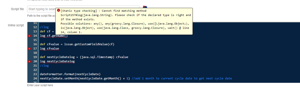

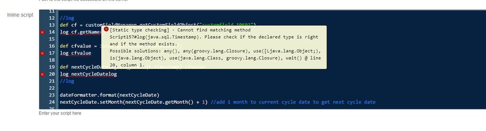

I'm having a bit of trouble with the logging method. Please see two screenshots showing errors.
Chris Ghazanchian
March 26, 2018
Fixed the logging problem by importing the logging package and changing log to log.debug throughout.

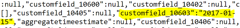

I am not sure how it sees it as null.. I go to http://myjirainstance:8080/rest/api/latest/issue/RAR-4 and have the value there:
