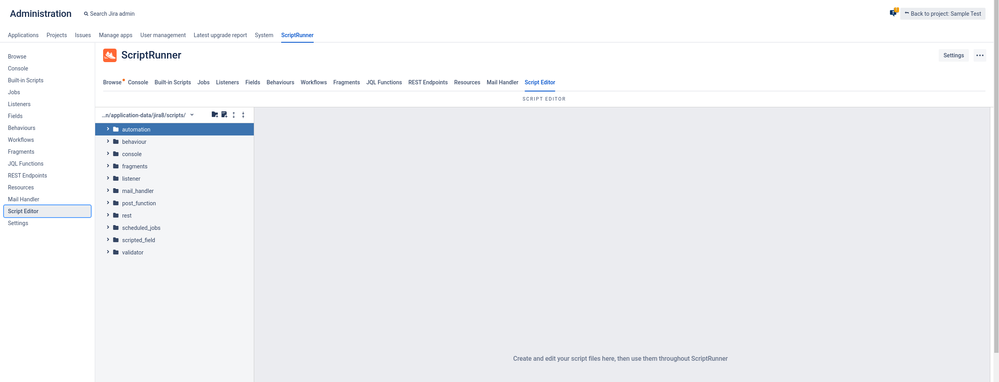

Could you please share a screenshot of your Script Editor, i.e. like:-
I am asking for this to understand how your packages are displayed.
Generally, the Groovy code files and packages should be added to the scripts/ folder, but I did not see it in your description.
