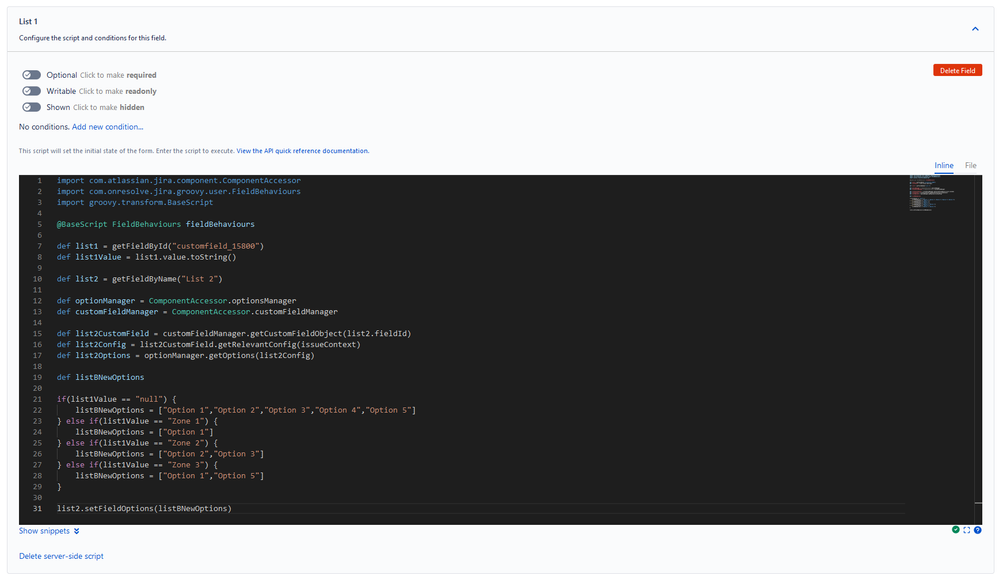

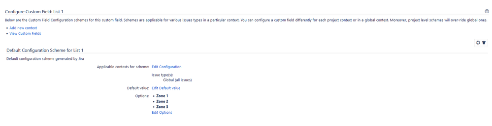

The coding is the exact same as below - but just with a different customfieldID:List 1 behavior.png

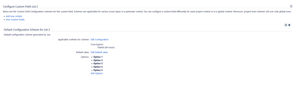

Here are the configs for the example list fields we used for this code:

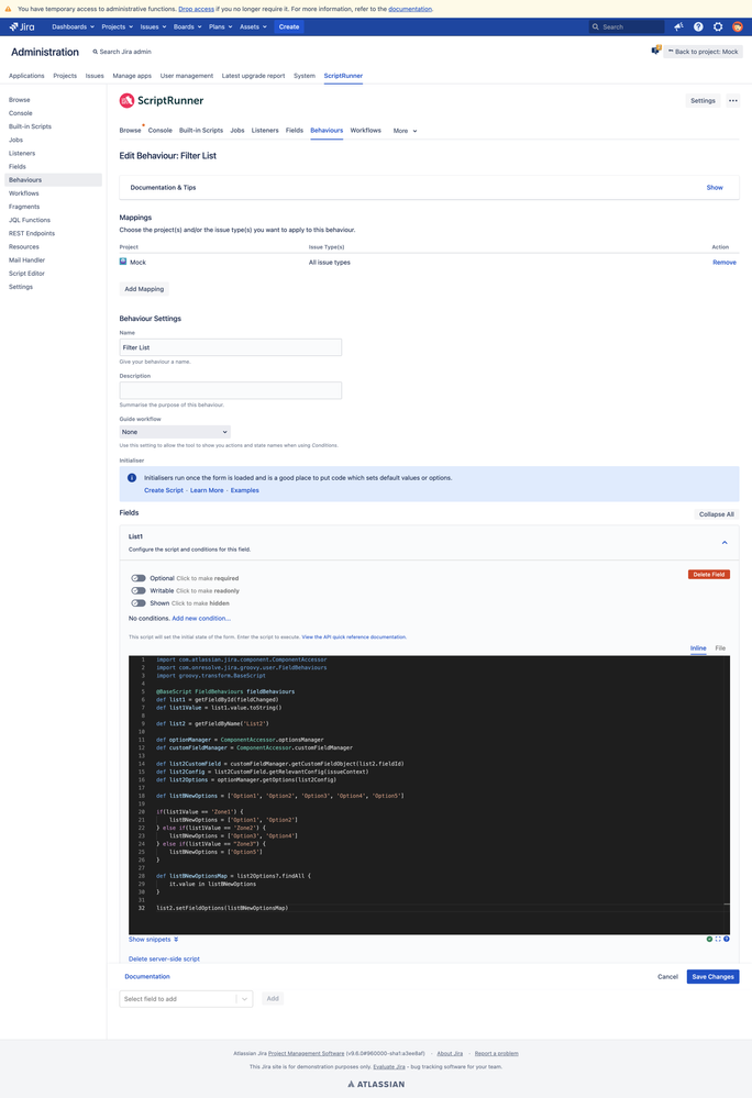

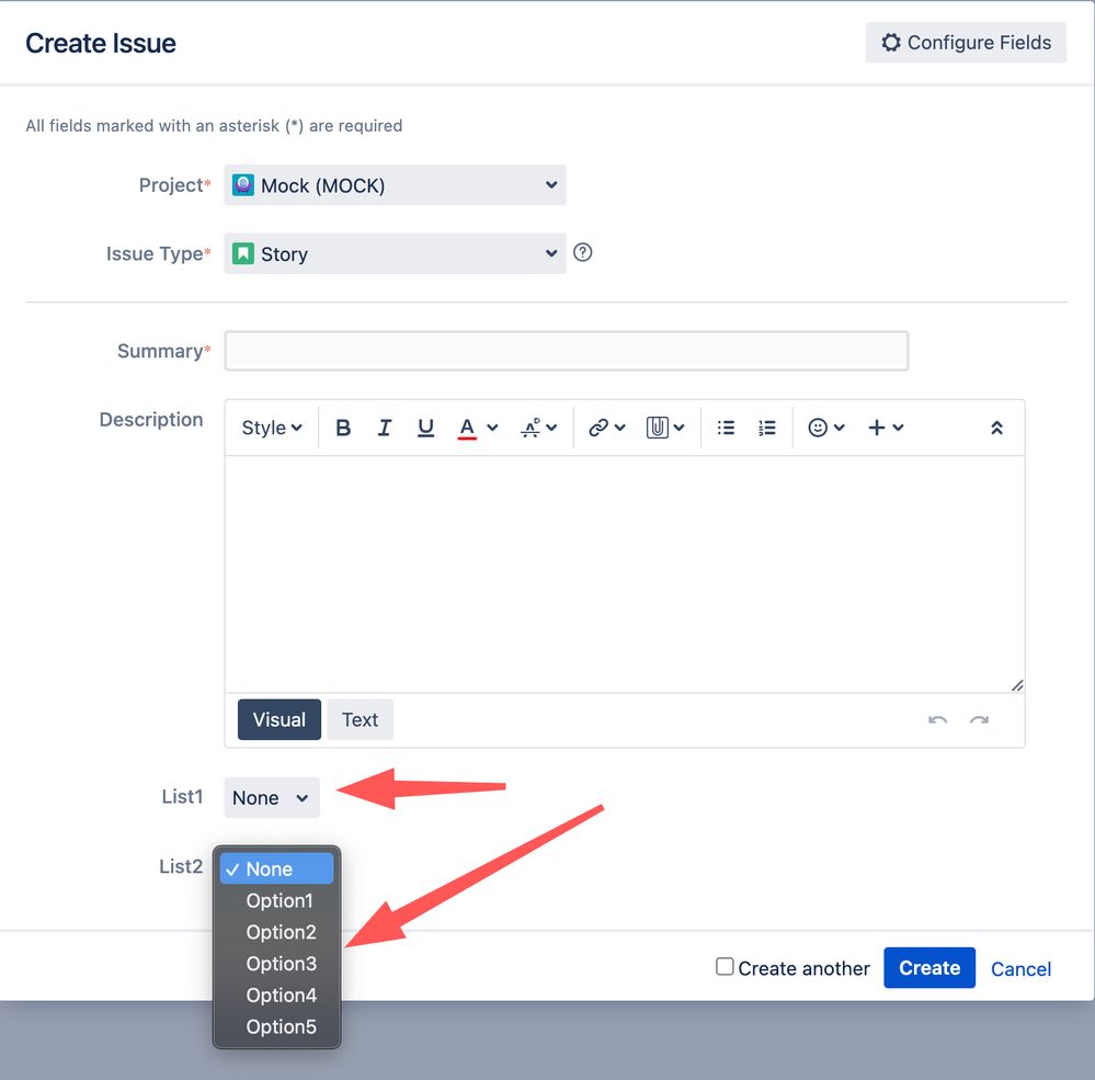

Below is a screenshot of the Behaviour Configuration:-
Also, you don't need to create a separate if/else condition for the None option.
Just set the default list options before the if/else condition. If none of the options is selected, the default options will be displayed in the second list.

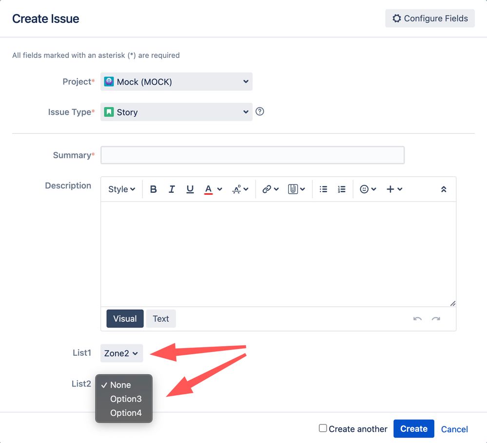

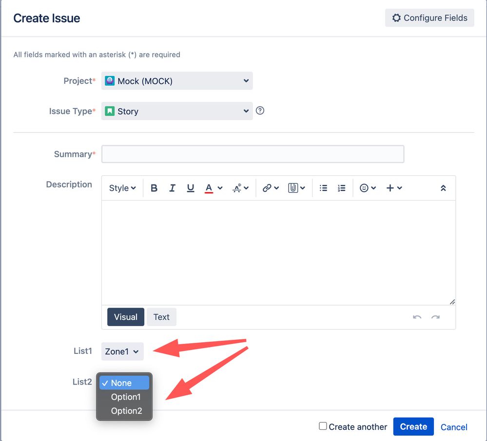

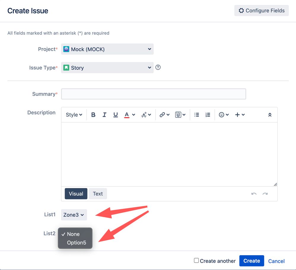

Below are a couple of test screenshots for your reference:-

Here is the completed code which works correctly for our needs:
import com.atlassian.jira.component.ComponentAccessor
import com.onresolve.jira.groovy.user.FieldBehaviours
import groovy.transform.BaseScript
@BaseScript FieldBehaviours fieldBehaviours
//the "ID" of the field goes where "12345" is if the field you are referencing is a custom field
def list1 = getFieldById("customfield_12345")
def list1Value = list1.value.toString()
def list2 = getFieldByName("List 2")
def optionManager = ComponentAccessor.optionsManager
def customFieldManager = ComponentAccessor.customFieldManager
def list2CustomField = customFieldManager.getCustomFieldObject(list2.fieldId)
def list2Config = list2CustomField.getRelevantConfig(issueContext)
def list2Options = optionManager.getOptions(list2Config)
def listBNewOptions
if(list1Value == "null") {
    listBNewOptions = ["option 1","option 2","option 3","option 4","option 5"]
} else if(list1Value == "Zone 1") {
    listBNewOptions = ["option 1"]
} else if(list1Value == "Zone 2") {
    listBNewOptions = ["option 2","option 3"]
} else if(list1Value == "Zone 3") {
    listBNewOptions = ["option 1","option 5"]
list2.setFieldOptions(listBNewOptions)
