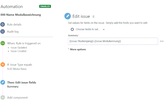

in Jira Automation I changed the Summary by concatenating two other issue field values as you see in the following figure.

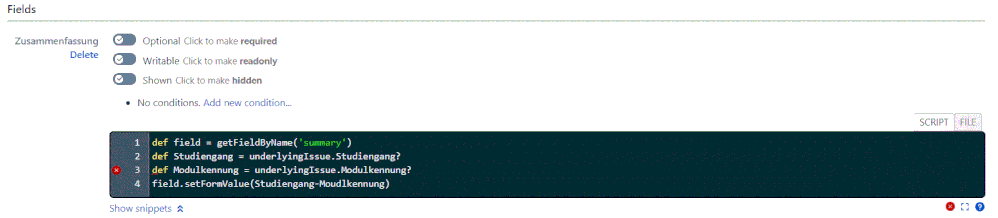

Now I want to achieve the same result using Script Runner. Therefore I am trying to set an Behaviour, which fail. In the following figure I show you my script. Maybe I also have to use a listener instead but first of all I want to understand the basic script structure :)

Hi there, your script looks like it should work but can I just check what the 2 fields are? I'm presuming these are custom fields, so you might need to use this instead -
def maxToleranceDateCustomField = ComponentAccessor.getCustomFieldManager().getCustomFieldObjectsByName("Max Tolerance Date")
def maxTolerancedatestartingvalue = underlyingIssue?.getCustomFieldValue(maxToleranceDateCustomField)
something along those lines, obviously change my field name for your field names.
Also if the fields are on the form you can use
def CFFieldVal = getFieldByName("Insert Custom Field Name").getFormValue()

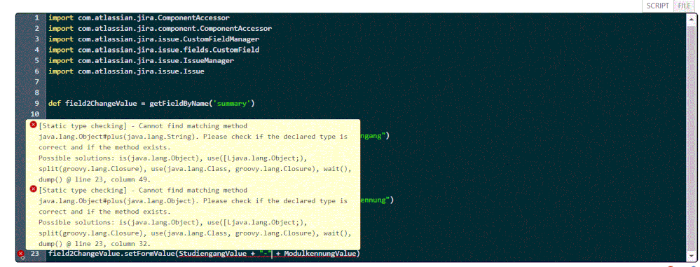

I changed my script using yours and I think we are way closer to the target. but some errors still remain.
as you see I did some imports, because I thought these would solve the problem. BTW do I have to always do some imports when I am using functions like this?
Then I believe the "-" character causes the last problem. In my automation rule from above I also used this as a seperator. The aim is to create summarys like "KDT-002". I dont want to subtract one from another. How am I supposed to code that? (BTW how would I do this if I literally would want to subtract, add or multiply fields with another?)
And lastly, could you please explain what you mean with "Also if the fields are on the form you can use". So what form do you mean?

There are multiple ways to achieve the string you want :
(Customfield1 + "-" + customfield2)
("${customfield1}-${customfield2}")
 if you wanted to subtract one from another I'm guessing they are both integers you can do just customfield1 - customfield2.
so using getFormValue() gets the value of that field on the form at that time, whereas underlying issue will get the value that is already saved to the issue.
I hope that all helps?

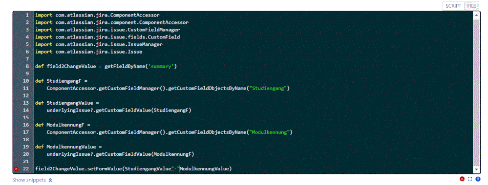

To achieve the string I tried both variants - but only the second one did work. In the figure below you see the error message I get using the first way.figure 4.GIF
Also I needed to change the "ComponentAccessor.getCustomFieldManager().getCustomFieldObjectByName(xxx)"-method in "ComponentAccessor.getCustomFieldManager().getCustomFieldObject(xxx)", to made this work.

That error is just static type checking and can be ignored in scriptrunner
