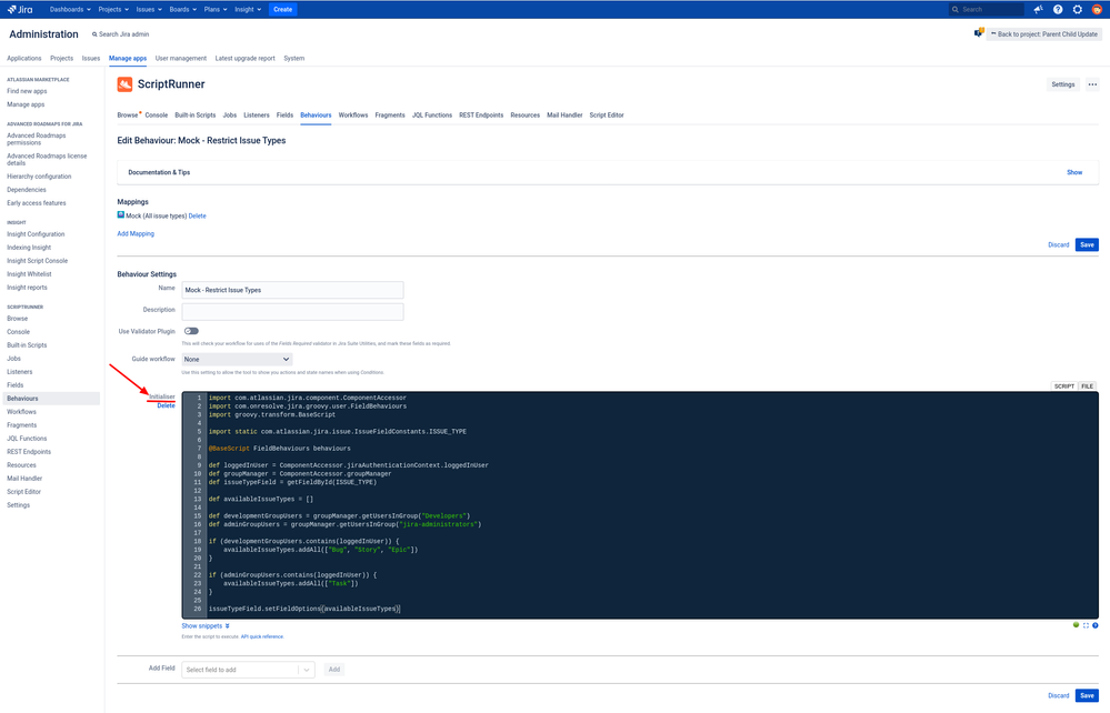

Below is a print screen of the Behaviour configuration:-
In this scenario, you will need to use the Behaviour Initialiser instead of the Server-Side Behaviour.
And the groups that are going to be tested is the jira-administrators group and the Developers group.
To invoke the groups you want to use, you will need to use the groupManager and specify the group names you want to use, as shown below:-
def groupManager = ComponentAccessor.groupManager
def developmentGroupUsers = groupManager.getUsersInGroup("Developers")
def adminGroupUsers = groupManager.getUsersInGroup("jira-administrators")
Next, you will need to modify the if condition, i.e. instead of using the User Role, use the Group to set the condition as shown below:-
if (developmentGroupUsers.contains(loggedInUser)) {
availableIssueTypes.addAll(["Bug", "Story", "Epic"])
if (adminGroupUsers.contains(loggedInUser)) {
availableIssueTypes.addAll(["Task"])

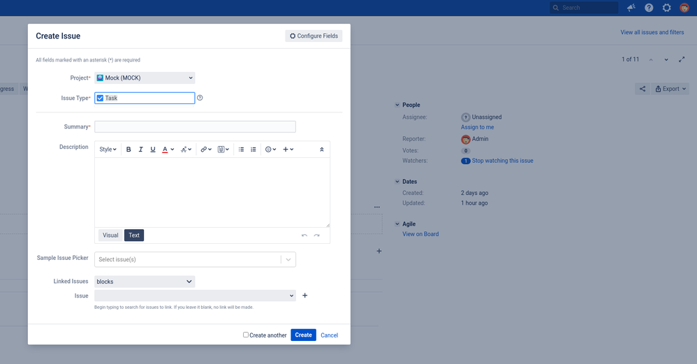

1) When the Admin user who is in the jira-administrators group is used, and the issue is being created, the user is restricted to only the Task issue type as shown in the image below:-

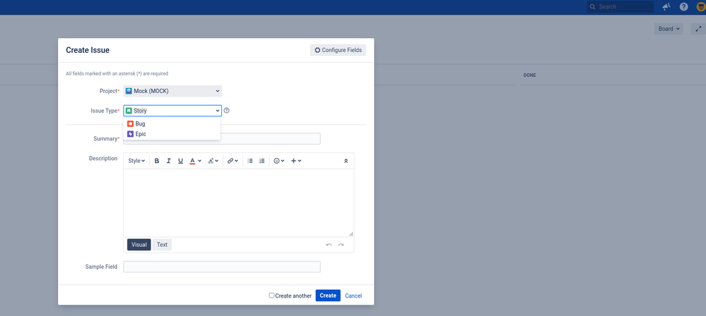

2) When the user Ram who is in the Developers group is used, the user is restricted to the BugStoryEpic issue types as shown below:-
