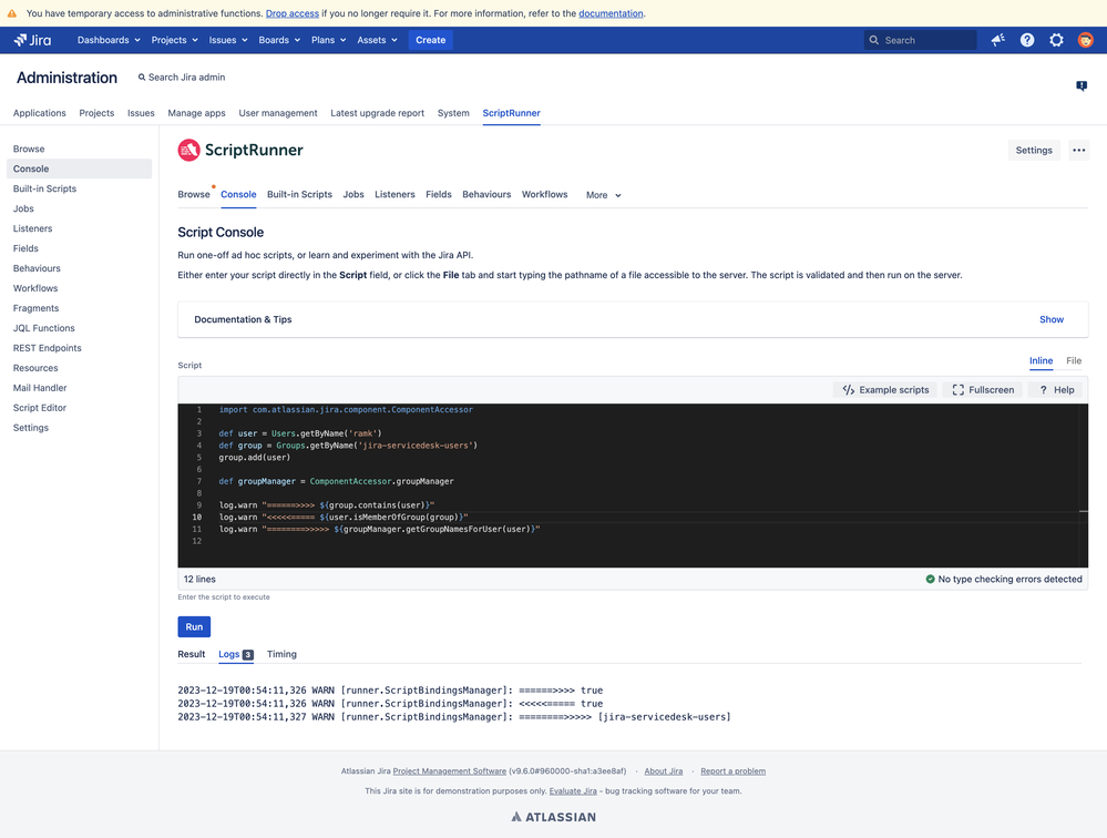

Below is a screenshot of the ScriptRunner console:-
As you can see in the screenshot above, when the code is tested, the verification returns true along with the group name the user belongs to in the log output.
Also, when checking the User Management page, as expected, the user is added to the group as shown in the screenshot below:-
I hope this helps so solve your question. :-)
