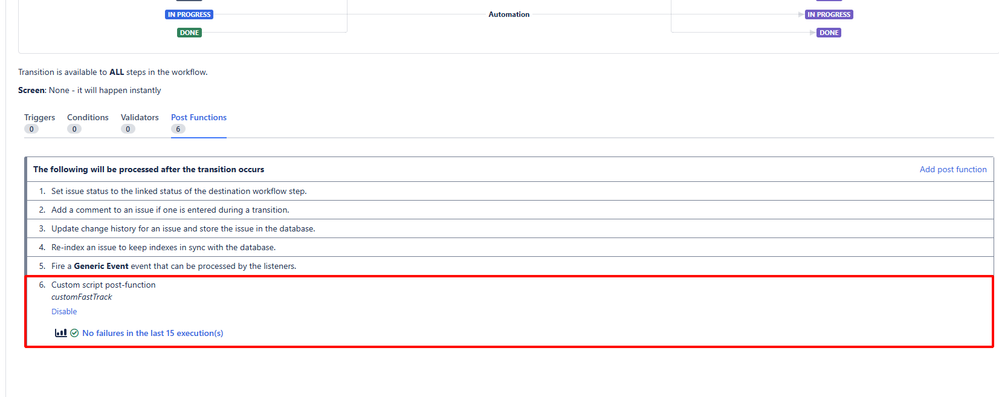

Ooh, i forgot mention that you have to put this script at the end of post-functions:

Thanks for this. Ive added the script to the end of the post function stack as the other was before, swapping out my map values and adding in some debug to see where it might fail.
It still errors out when attempting to call the function to handle the transition. I notice on your screenshot it seems this is not in the create transition. While the normal fast track post function works there, im curious if an issue here for it?
