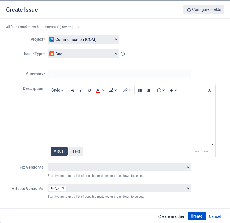

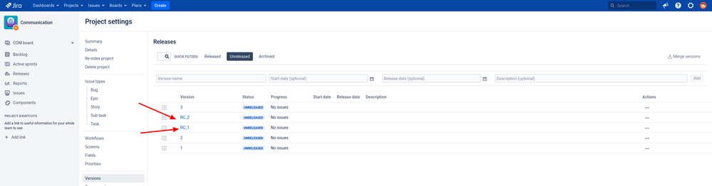

Below is a print screen of the versions available for testing:-
Below is a print screen of the sample test. As expected, the latest RC version is selected.
I hope this helps to solve your question. :)
