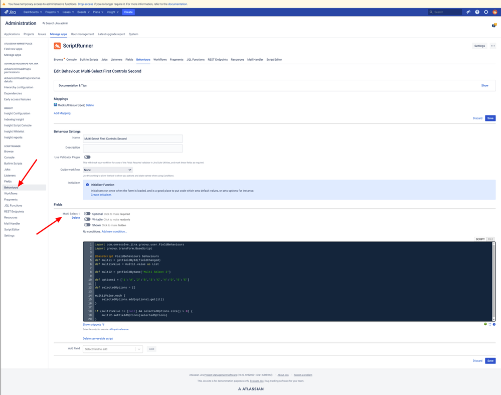

Below is a print screen of the Behaviour configuration for your reference:-

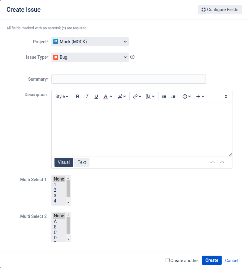

1. When the issue is being created, and no selection is made from the first Multi-Select field, all the options in the second Multi-Select field are also visible as shown in the image below:-

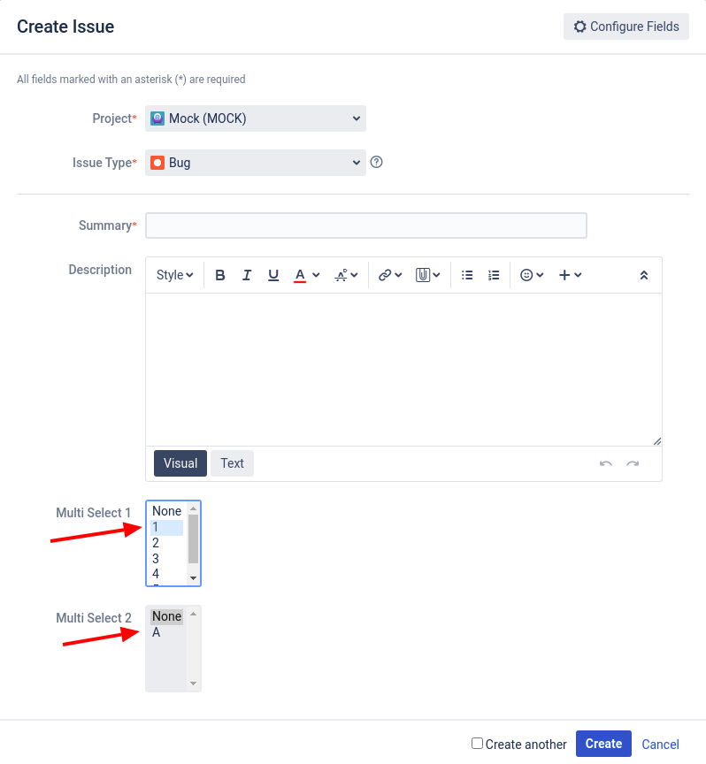

2. Once the options are selected in the Multi Select 1 field, the options in the Multi Select 2 field will be filtered accordingly, as shown in the images below:-

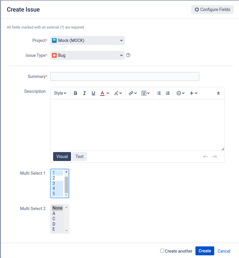

3. The same also applies when multiple options are selected from the Multi Select 1 field, i.e. accordingly, multiple options will also be displayed in the Multi Select 2 field as shown in the image below:-
