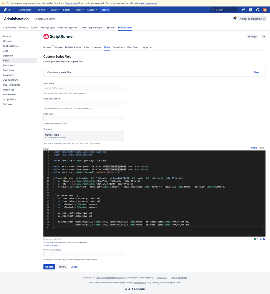

Below is a screenshot of the Scripted Field Configuration:-
The main calculation is performed by the monthsBetween(...) method. It counts the difference between the two dates in Months.

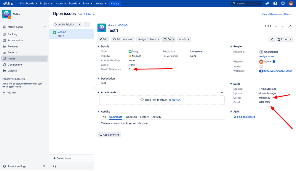

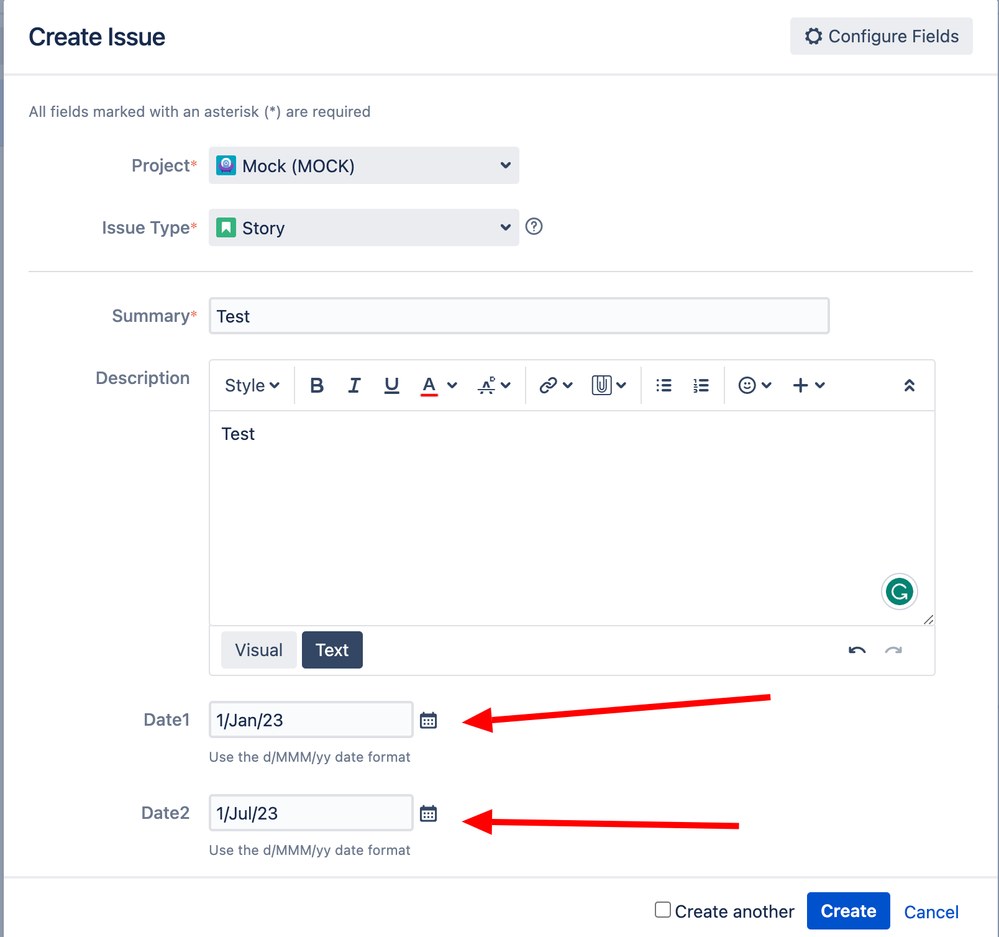

1. When the issue is being created, both the date fields must be filled. The Scripted Field will also be empty if either date field is empty. In this example, for Date1, the date has been set to 1st January 2023; for Date2, the date has been set to 1st July 2023.
2. Once the ticket has been created, as expected, the Scripted Field is displayed with the difference between the two dates in Months. The screenshot below shows that the Scripted Field displays the value of 6, i.e., six months difference.
