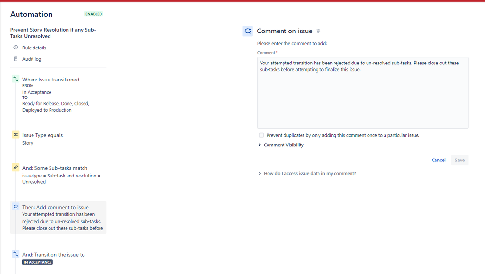

Marq Herrod
December 19, 2022
Hey @David Willox  did you ever find and/or come up w/ a solution for how to do this?
I'm struggling to solve precisely this scenario and I've tried multiple other options including automations, post-functions, etc... All to no avail thanks to how Jira Cloud only fires the listener after all conditions/validators are run, meaning the issue gets blocked before any real-time notification can be displayed.
Best I've come up with thus far is this automation below that drops a comment on the issue after the transition is blocked which I'm now contemplating turning into an email to the user instead...image.png
