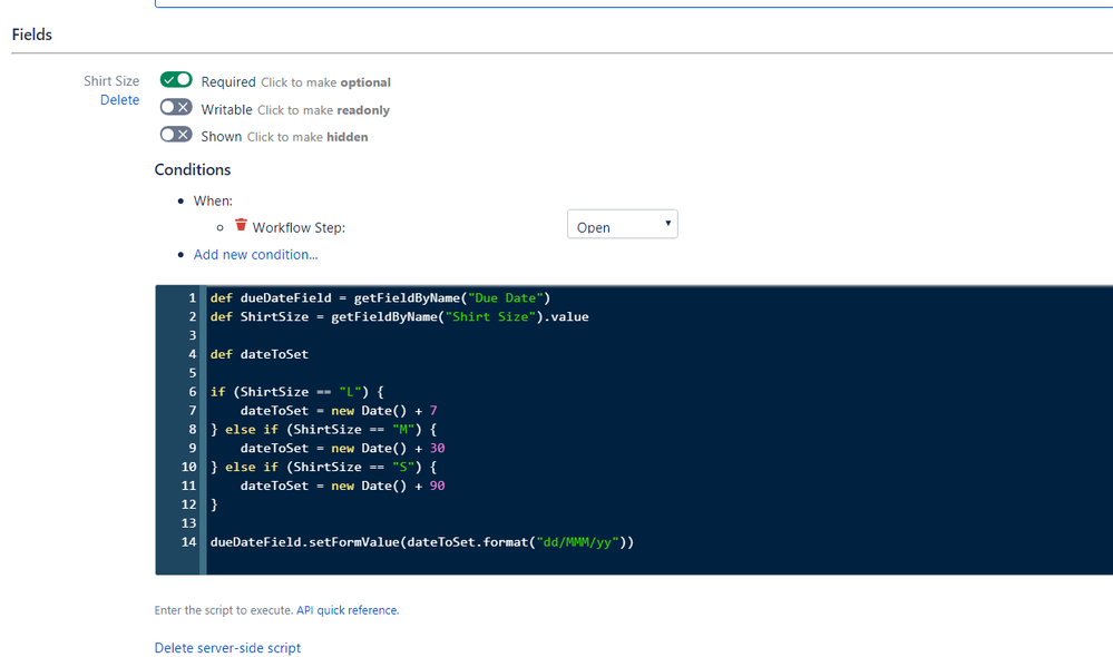

Create a behaviour on the "RiskLevel" field with the following server-side script:
def dueDateField = getFieldByName("Due Date")
def riskLevel = getFieldByName("Risk Levels").value
def dateToSet
if (riskLevel == "High") {
dateToSet = new Date() + 7
} else if (riskLevel == "Medium") {
dateToSet = new Date() + 30
} else if (riskLevel == "Low") {
dateToSet = new Date() + 90
dueDateField.setFormValue(dateToSet.format("dd/MMM/yy"))

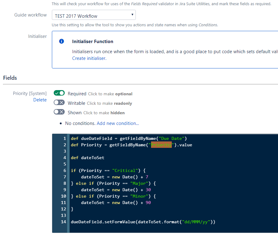

I have tried this on a test project by using Priority field instead of Risk Level and it does not work. Please see the screen shot below. Do you see anything wrong it?
Thank you.
Like Saitej Namburi likes this
Roland Holban (Adaptavist)
August 15, 2018
Calling getValue() on the priority field actually returns a Priority object. So to use it like you want to you have to access its name property:
def priority = getFieldById("priority").value.name
Also, Im not sure why your field is called "Priority [System]", every time I've seen it was always just called "Priority"...

@Roland Holban (Adaptavist)
Here is what I have tried and still nothing. Any ideas why?
Thank you for your patience and understanding.

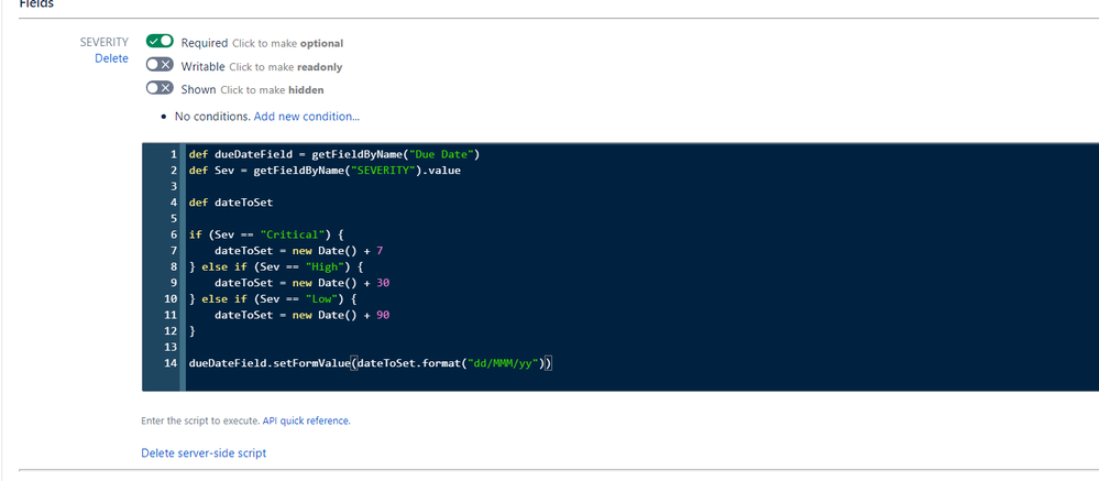

Elif Alverson
August 20, 2018
I also tried with a custom field called " SEVERITY" to see of it works. But it did not. Does it work on your system? We use Jira v7.11.2, not sure if that makes any difference.

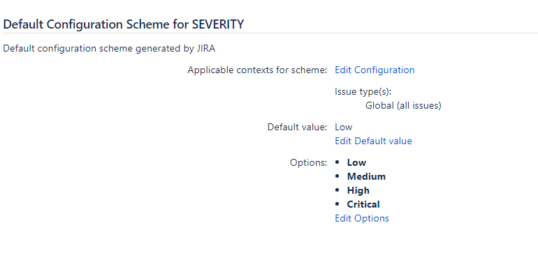

August 20, 2018
What type of field is SEVERITY?
Elif Alverson
August 20, 2018
August 20, 2018
That should definitely work...

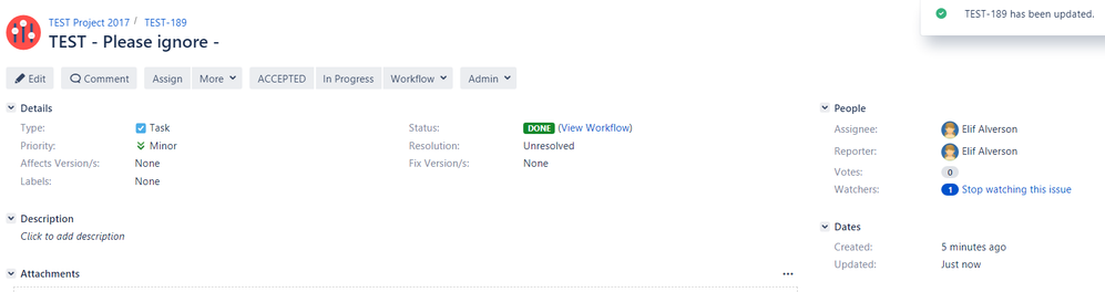

Elif Alverson
August 20, 2018
I tried to add conditions , no change. I change the severity on the ticket several times but no values are being assigned to " due date" . Please see below screen shots.
Like Zhuxin Wang likes this
Dave Liao
November 3, 2020
@Elif Alverson (and to anyone else running into this issue), use getFieldByID("duedate"). Due Date is a Jira system field, so you need to pull it by its ID.
