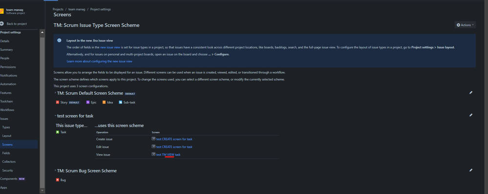

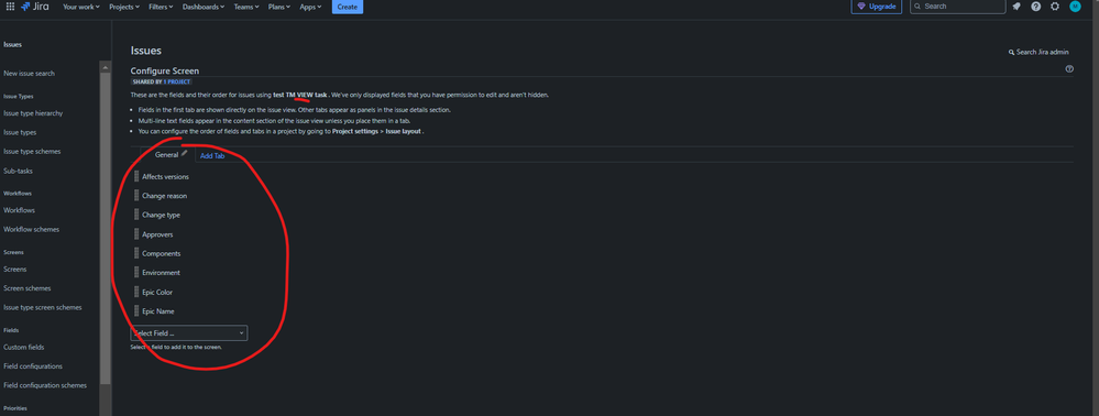

Here I can edit the fields for Issue type Task and Operation type - view
have a look:
I've added the screen to provide more info.

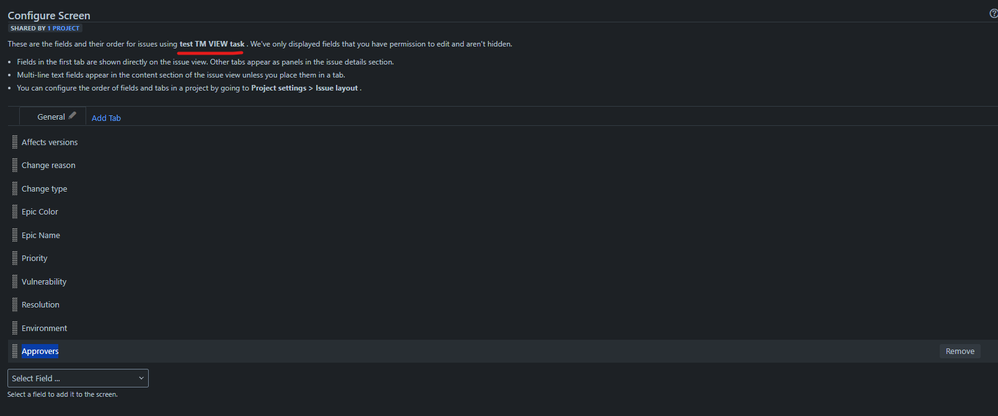

The problem is the following:

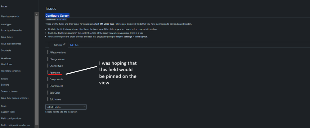

By adding the field Approvers (via the Configure Screen) I was expecting that I couldn't remove this field from the issue layout. But it not working like I was expecting.
Could you provide some info?

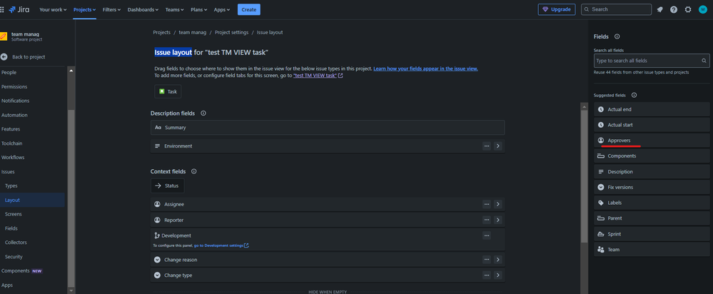

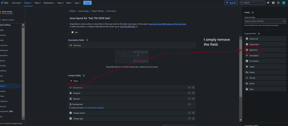

In fact my scope of the fields is not correct here:
So I renewed the script and noticed that the field Approvers is still there, but why is it so?
Two ways should work here (in my mind):
1. the field should disappear on the "Configure screen" after I delete it from the "Issue layout"
2. I should get some error message informing me that I can't delete the field on the "Issue layout" because I've chosen this field on the "Configure screen".
But none in this way was working at all.
Could you share your thoughts?

Hi @[deleted]
There is a difference in Layout on project level and Screens.
On screens you decide which fields are on a certain screen and these can be used in screen schemes and a screen scheme can be used in an issue type screen scheme.
The layout option is there to provide project admins the choice to define which of the fields from the screen to show on the issue in their project
They are not related, in the config you can add any field from the system, but if it's not on the screens used in the project the field can't be used.
Check for infromarion on issue layouts here, https://support.atlassian.com/jira-cloud-administration/docs/configure-issue-layout/

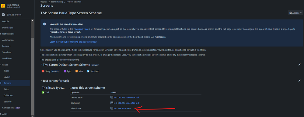

clicking on the task I am going to "activate" Issue Layout settings, but not the Operation View issue, is it so?
It is not the same (issue Layout settings and Operation - View issue)?
If this is not the same, how to "activate" the settings of Operation - View issue?
Kindly let me know.

Not this is not the same.
In a screen scheme you have 3 operations.
This means you can have a different screen for each operation.
This provides you to have a limited just need fields on creating an issue, have fields on the edit screen only to be filled after create an a view screen when fields can be used that you only want to show, but no editable.
Here you can find documentation on screens, screen schemes and issue type screen schemes.
manage-issue-screens

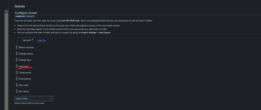

I've added the field Approvers again on the screen here:
To see what is going to change on Issue Layout. So the newly added field appears here:
Why is it so?
There should be some correlation between the Configure Screen and  Issue Layout. I just can't get it(
