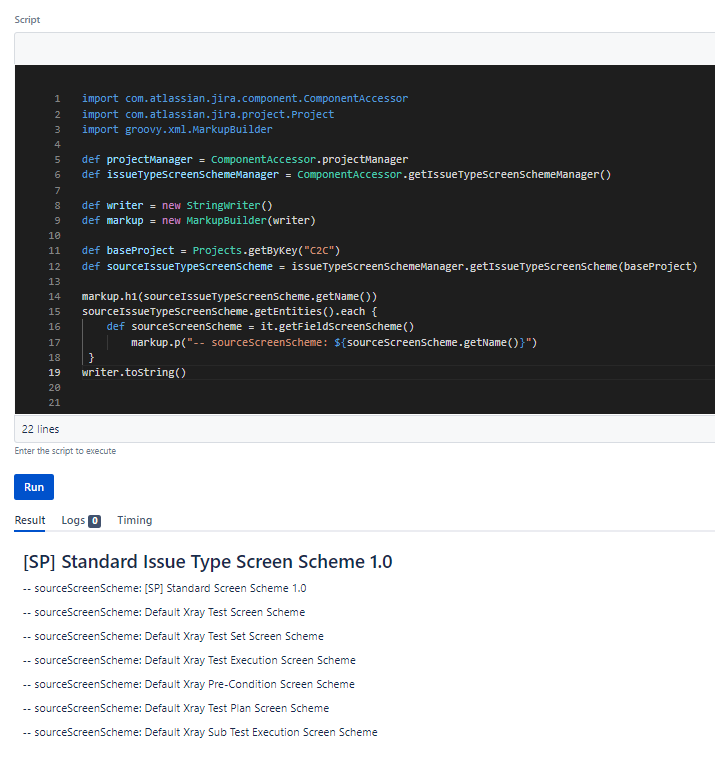

I'm working on a script to fetch custom fields in a project, and I started to do this by fetching the Issue Type Screen Scheme first, when I noticed that the Issue Type Screen Scheme Manager class returned some Screen Schemes that are not assigned to the project at all.
Below is a code snip that represents the situation clearly:
My Code:

My Output:

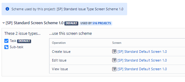

Actual setup
Does anyone have an idea why this happens?
It is mostly that the output returns Xray's schemes, but on some projects that I tested I got some regular schemes as well. I tried to clear my browser cache as well, but the problem persisted.
Thank you!

The screenshot does not show the actual issue type screen scheme but lists only the screen schemes for the issue types that are configured in your specific project.
So, the issue type screen scheme includes more screen schemes for some issue types (probably some Xray testing issue types), that are not shown in the project configuration, since the issue types are not active in that project.
To check the "real" configuration of your issue type screen scheme go to the global administration:
cog icon -> Issues -> Issue Type Screen Schemes -> '[SP] Standard Issue Type Screen Scheme 1.0' -> Configure
