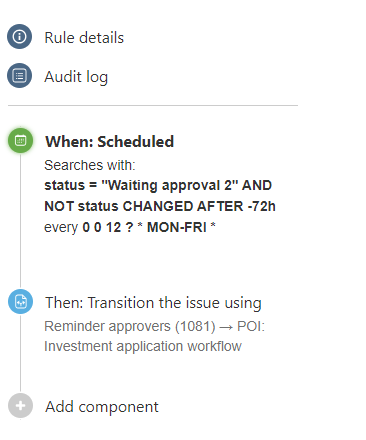

I have created three scheduled automation rules that will be running once a day to remind the approver in the different levels if they haven't approved the issue after 3 days.
One example of the JQL:s that I have created for one scheduled reminder is:
status = "Awaiting Region Manager" AND NOT status CHANGED AFTER -72h

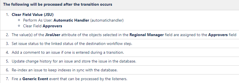

The problem is that this JQL is only working the first time because in the same automation rule I triggers a self transition FROM status "Awating Region Manager" TO status Awating Region Manager" via transition "Reminder approver".
In this transition I clear the approver field and sets it again through a postfunction. The reason for this is to trigger the Customer notification for Approval Required again.

A scheduled automation rule runs once a day mon-fri with below settings:
When the automation rule runs at 2023-12-04, the JQL search will result in ticket X if the ticket has not been approved and that ticket will be transfered FROM status "Awaiting approval Region Manager" TO "Awaiting approval Region Manager" via Reminder approvers transition.
The next day the ticket is still in pending approval and I want to remind the approver again but when the rule runs, the search result is 0 ticket. This because the status was changed yesteday and the condition NOT status CHANGED AFTER -72h "fails".

I saw that I sent a print of the automation rule for another approval step. The status in the automation rule I use as an example is of course "Awaiting approval Region Manager"
