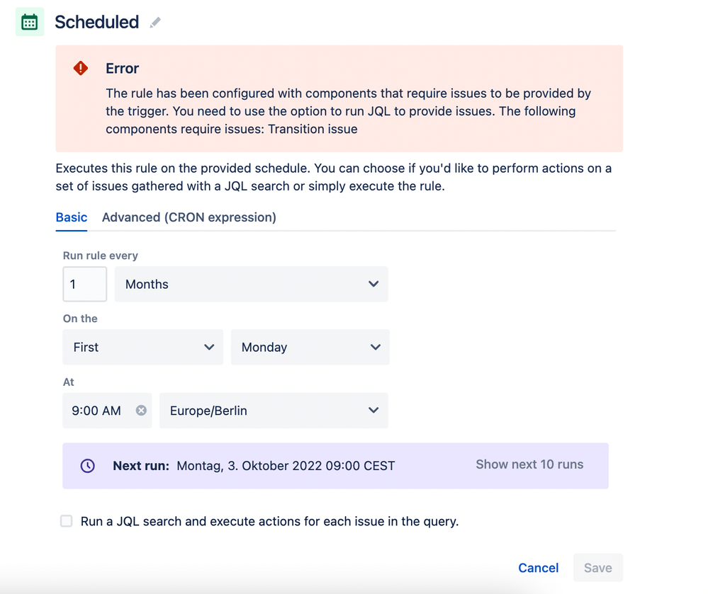

When saving and trying to publish we get an error:
The rule has been configured with components that require issues to be provided by the trigger. You need to use the option to run JQL to provide issues. The following components require issues: Transition issue

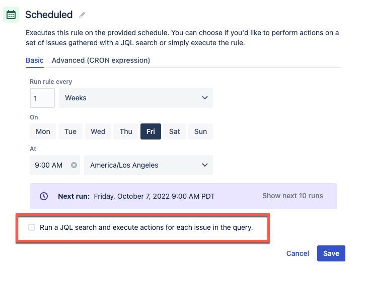

Hi @Patrick Tresp - You can bypass the requirement for JQL

Thanks for quick reply. Unfortunately i can not bypass this, because an unchecked box leads to this error where i need to run JQL queries:

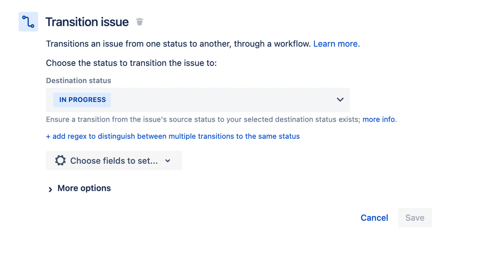

The transition itself is pretty default so there should not be the cause of the JQL requirement?

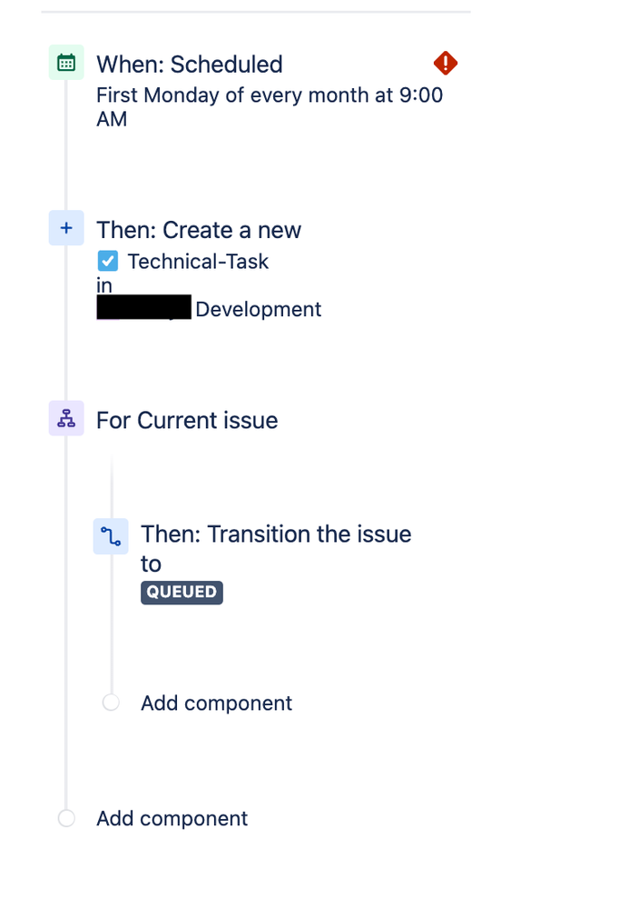

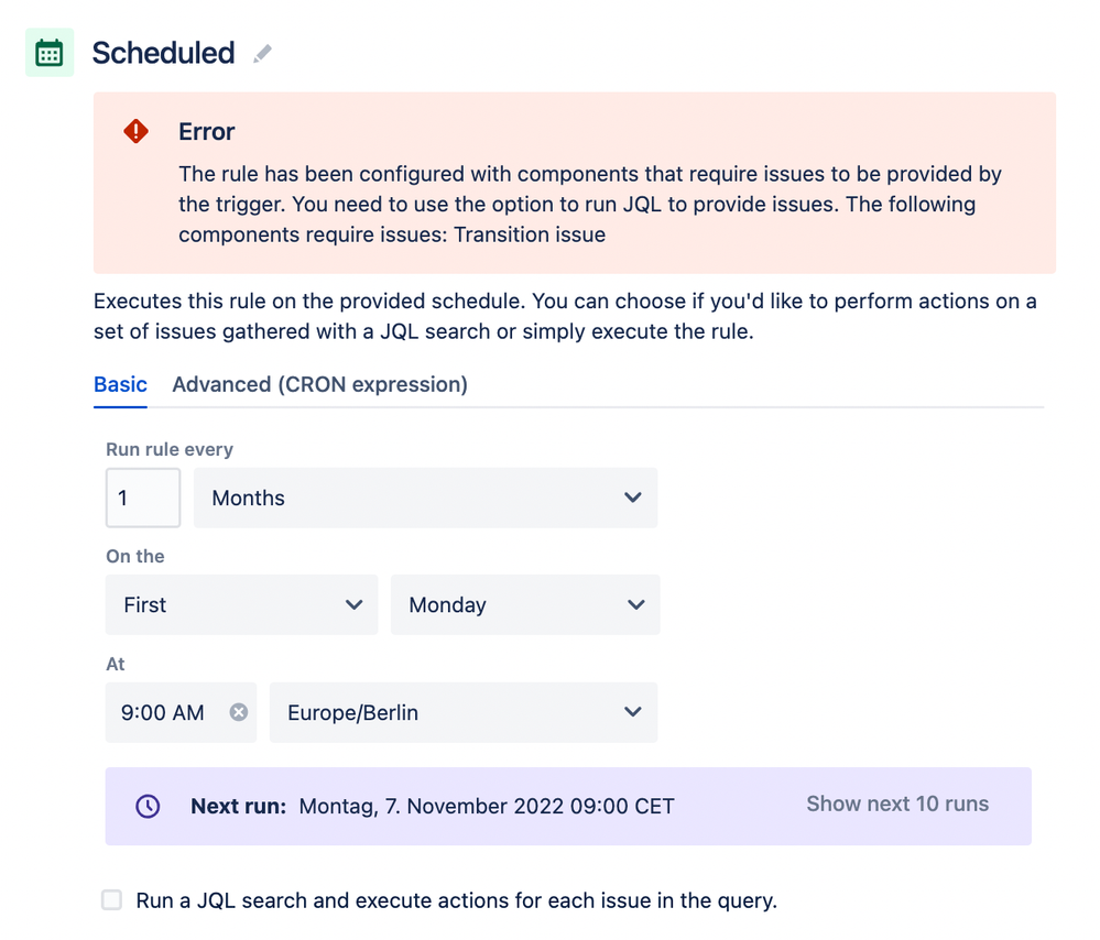

I set it up fresh and did set it up as suggested, and it i am facing identical issue here:
Bildschirmfoto 2022-10-04 um 06.02.49.pngBildschirmfoto 2022-10-04 um 06.02.56.png
So i see there is no workaround using that JQL for now?

You have it set to branch on current issue for which there is no context.  It should branch on "Most recently created issue" instead.  That should address the error.
