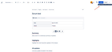

I reproduced the same steps you did and when I reached the report page and hovered the mouse in the Close button, the message returned is the warning "Saves changes without publishing", as you can see in the screenshot below:

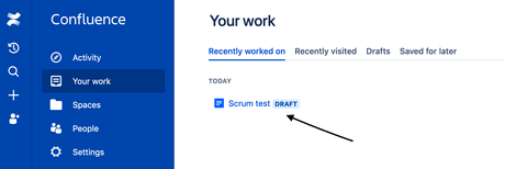

Indeed, the report was saved as a draft in Confluence, which can be accessed by clicking on "Your work" and selecting the tab "Recently worked on":
Can you please check if you are able to find your report on the menu described above?

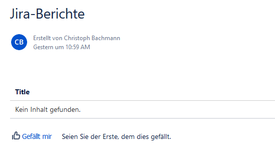

But unfortunately I can't see "Your work" in Confluence:
And even under the report areas there is no report.
Is there any setting I am missing?
