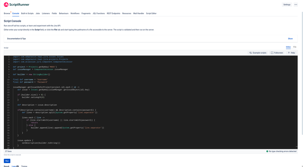

For your requirement, you can try something like below on the ScriptRunner console:-
import com.adaptavist.hapi.jira.issues.Issues
import com.adaptavist.hapi.jira.projects.Projects
import com.atlassian.jira.component.ComponentAccessor
def project = Projects.getByKey('MOCK')
def issueManager = ComponentAccessor.issueManager
def builder = new StringBuilder()
final def username = 'Username'
final def password = 'Password'
issueManager.getIssueIdsForProject(project.id).each { id ->
def issue = Issues.getByKey(issueManager.getIssueObject(id).key)
if (builder.size() > 0) {
builder.setLength(0)
def description = issue.description
if(description.contains(username) && description.contains(password)) {
def lines = description.split(System.getProperty('line.separator'))
lines.each { line ->
if (line.startsWith(username) || line.startsWith(password)) {
return
} else {
builder.append(line).append(System.getProperty('line.separator'))
issue.update {
setDescription(builder.toString())
Please note that the sample working code above is not 100% exact to your environment. Hence, you will need to make the required modifications.

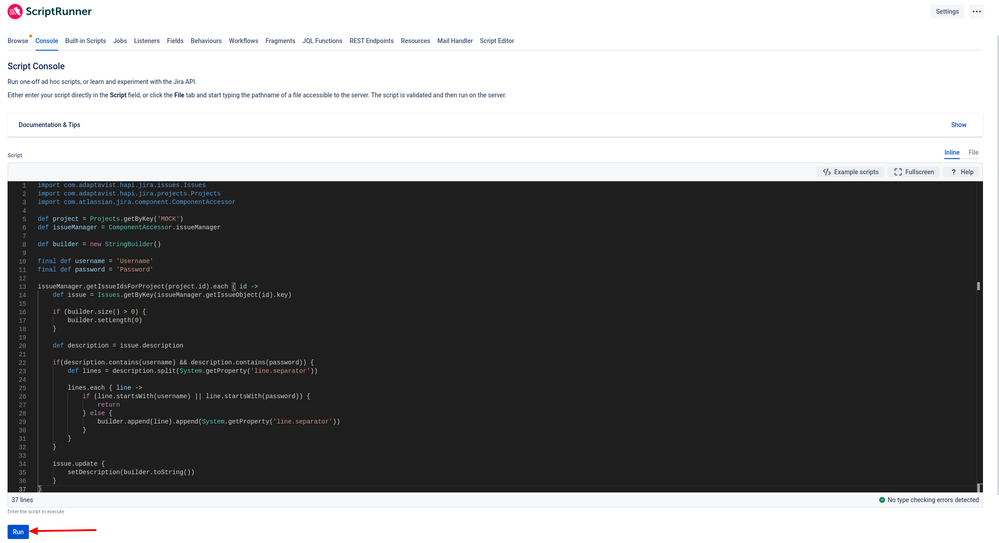

Below is a screenshot of the ScriptRunner Console configuration:-

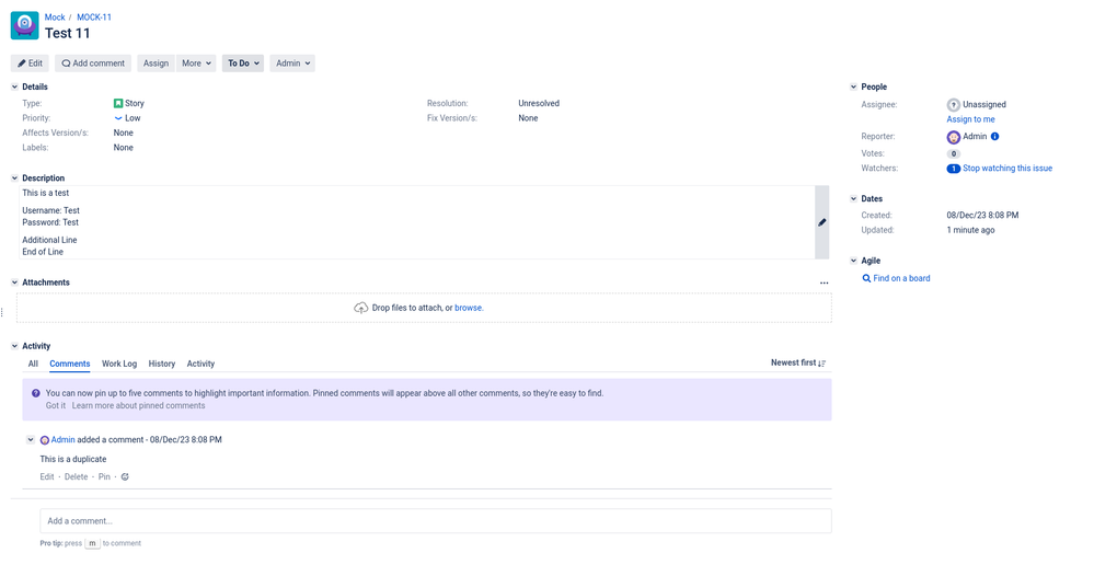

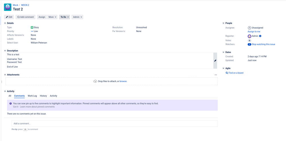

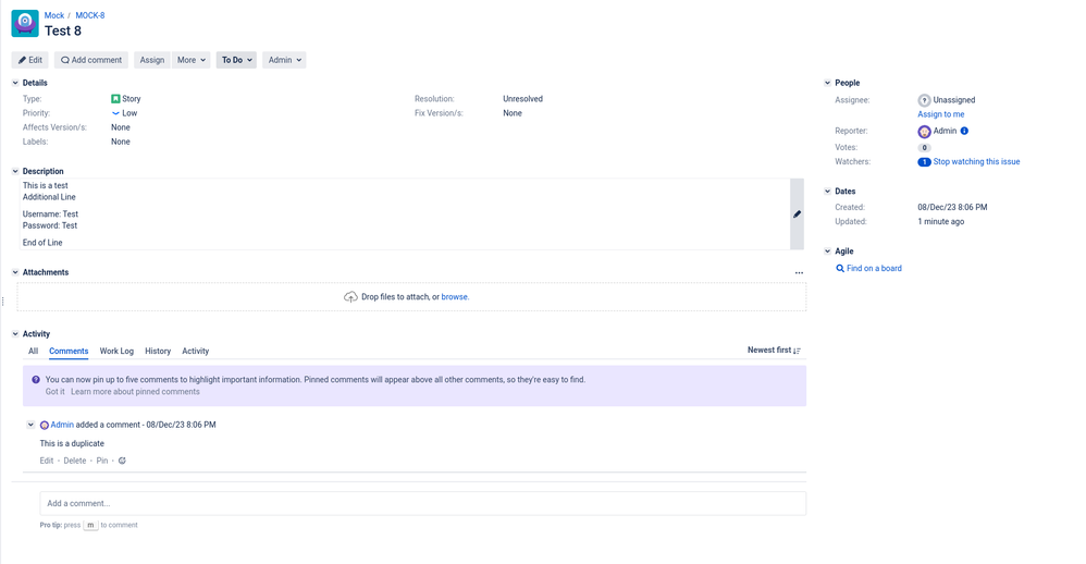

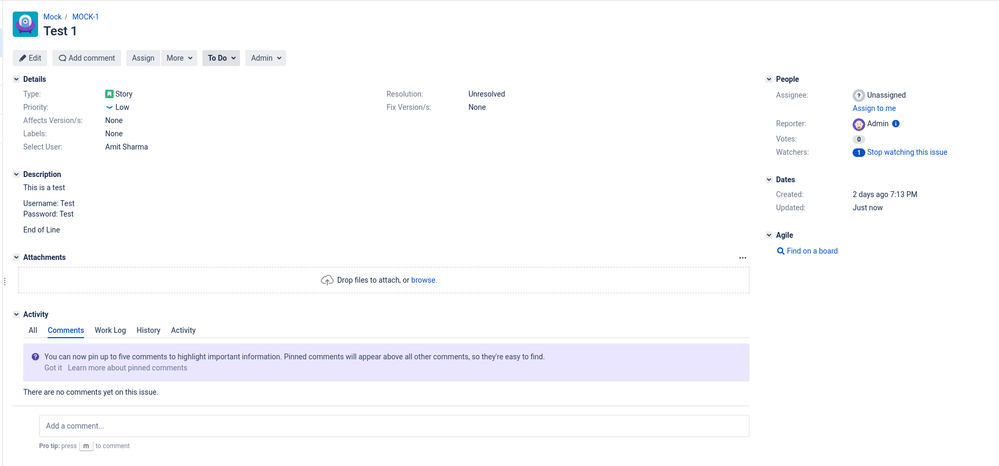

Below are a couple of test screenshots for your reference:-
1. The screenshots below display all the issues where their description contains the username and password values before the script has been executed.
2. Next, in this screenshot I am executing the script

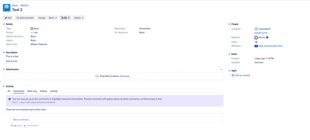

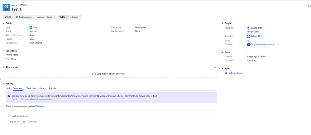

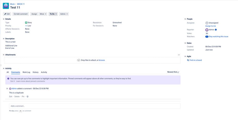

3. Finally, in the next screenshots, you can see that the usernames and passwords have been removed from the issue descriptions.
