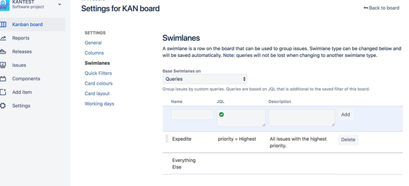

I couldn't recreate that in my Jira Cloud instance. Here's what I see on a new project/board:
For me, 'Everything Else' is at the bottom and all is good 👍

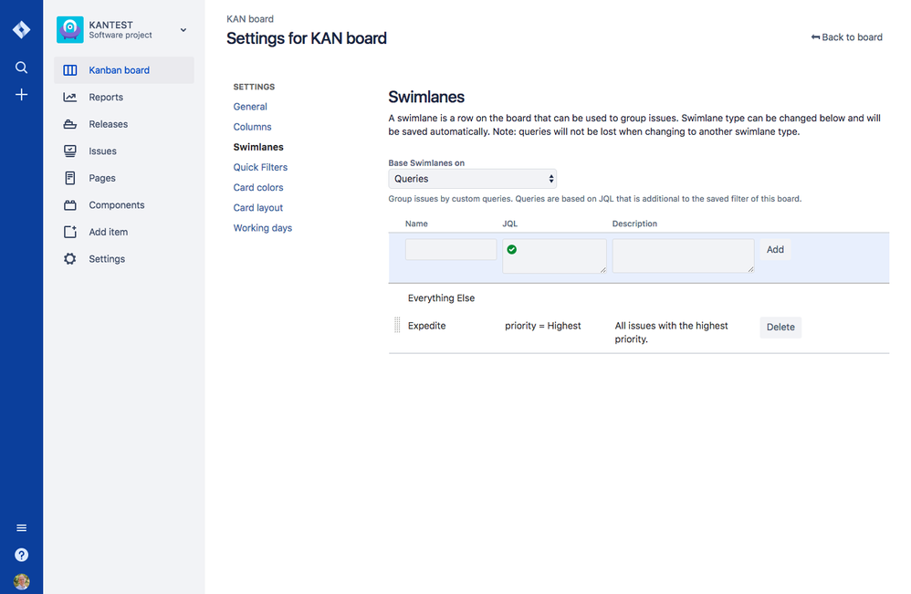

Well, perhaps that is the way it *should* work.  But that is not what is happening right now.  Hence why I say bug.
This is easy to repro: Create a bran-spakin' new kanban project.  Go to swimlanes.  See below.
And same happened when I created my first Kanban project, populated with sample data.  The kanban template appears to be "malformed" and has the catch-all at the top.
