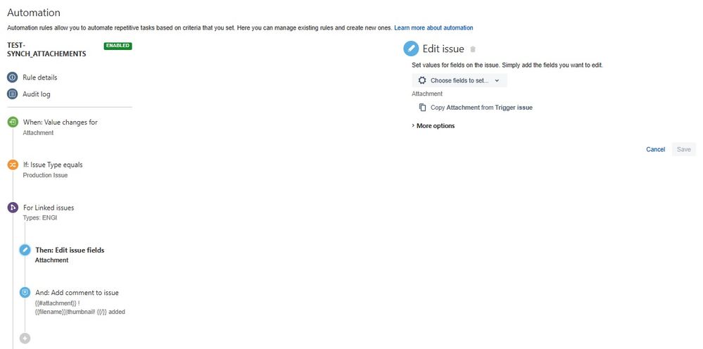

Brothers & Sisters,
I see there is already a BUG in jira regarding SYNC comments with attachements but there is workaround proposal that I am trying to use.
Its simple logic taken from official atlassian web side.
1. When ticket is edited -> field Attachements
2. Issue type condition
3. For linked issues type XYZ
4. EDIT field Attachements -> Copy From trigger issue
5. Add a smart value comment
ISSUE OF THIS SOLUTION I AM FACING
1. I have Ticket A as a source of attachements
2. Ticket B that should copy attachements from Ticket A once they are uploaded to ticket A
In Other words, when Ticket A has new attachement copy it to Ticket B
BUT!!
1. This solution works only for 1 TIME sync.
2. If I upload Attach1 to Ticket A -> Attach1 is copied to Ticket B (PERFECT)
3. If I upload Attach2 to Ticket A -> Attach2 IS copied to Ticket B but also Attach1 is copied again
at the end of this Ticket A has 2 attachements and Ticket B has
Attach1 x2
Attach2 x1
If I upload Attach3 to ticket A then again Ticket B will take all of attachments AGAIN + Attach3.
Ticket B does not recognise "NEW ATTACHEMNT" from Ticket A.
I believe its common issue and i am wondering if it is feasible to resolve with automation only....

@Mateusz Janus
That behavior is exactly what I’d expect from that setup.
The key point is: “Copy attachments from trigger issue” is not a delta-sync. It’s a full copy. Every time the rule runs, Jira just grabs everything from Ticket A and applies it to Ticket B again. Jira Automation doesn’t have the concept of “only the newly added attachment”, so Attach1 gets copied again when you add Attach2, then again when you add Attach3, etc. That’s why you end up with duplicates.
And you’re also right about the trigger problem: there isn’t a clean “Attachment added” trigger (especially in DC) that lets you reliably catch just the new file and act only on that one.
So if you want to solve it, you’re basically choosing between two realities:
 “Mirror mode” (automation-only, stable):
Before copying, delete attachments on Ticket B, then copy from Ticket A.
Result: no duplicates, but Ticket B becomes a mirror and you’ll wipe anything extra added directly to B.
“True sync” (only copy what’s new):
That needs scripting / app logic. You need something that can compare attachment lists and copy only the missing ones. Automation alone can’t really do that cleanly.
So short version: automation can mirror, but it can’t do real incremental attachment sync without duplication.

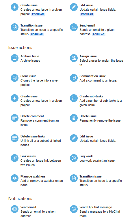

Mateusz Janus
March 1, 2026
@Arkadiusz Wroblewski for quick win solution I shoose MIRROR remove all attach and upload again full list. Maybe one day Script Runner gonna be my new friend BUT NOT TODAY : D
The problem is... I am just checking list of available ACTIONS and I do not have action like "DELETE ALL ATTACHEMENTS"... so how to remove them?
March 1, 2026
@Mateusz Janus
Which DC Version you have?
Mateusz Janus
March 1, 2026
  • (v9.12.1)
March 1, 2026
@Mateusz Janus
Either your Automation Component is outdated or your user don't have sufficient permission in this Project for delete own and others attachments.
Like Mateusz Janus likes this
Mateusz Janus
March 1, 2026
@Arkadiusz Wroblewski amazing.... you were right. I granted permission to AUTOMATION actor and there is !! Thank you !!! once day when I grow up I am gonna be like you!!

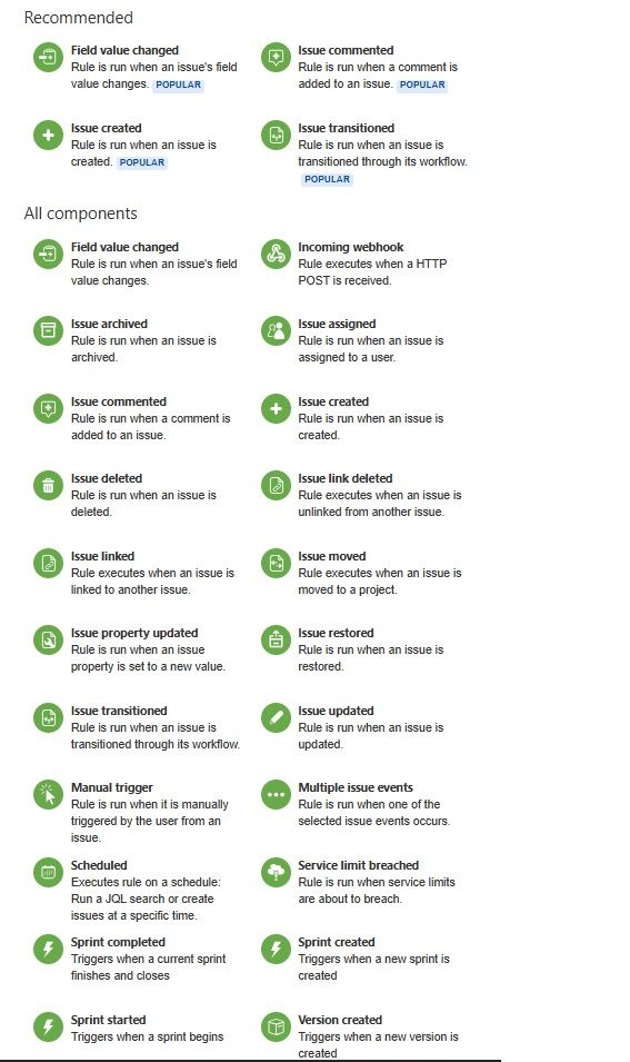

Florian Bonniec
February 28, 2026
Hi @Mateusz Janus
I do not have a DC version on hand for now, but instead field change on attachment is there an event Attachment added instead ?
Regards
Mateusz Janus
February 28, 2026
hi @Florian Bonniec i was thinking about same. Differente trigger but there is no dedicated trigger for attachements. :(
There is generic "issue updated" but dont know how to use this trigger tbh

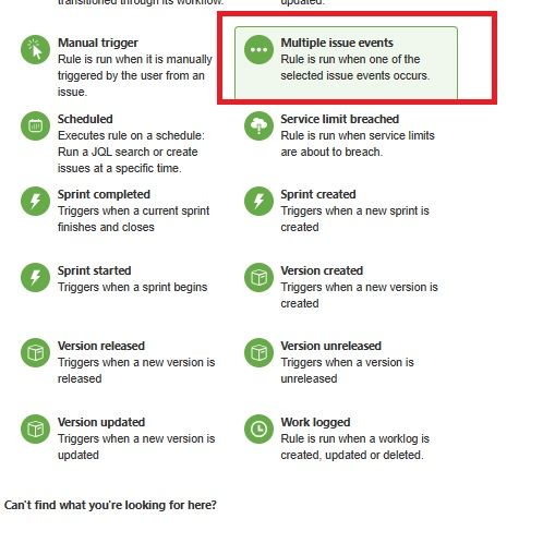

Florian Bonniec
February 28, 2026
Nothing available in Multiple issue events too ?
Mateusz Janus
March 1, 2026
@Florian Bonniec
i do have multiple issue events. What is your idea regarding this trigger?
