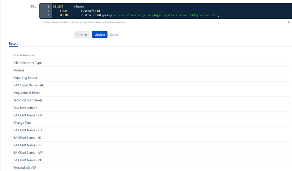

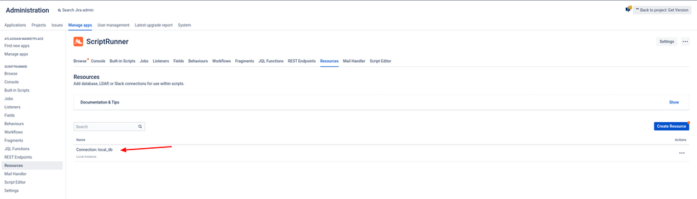

Below Screenshot when running query on Local Database connection.

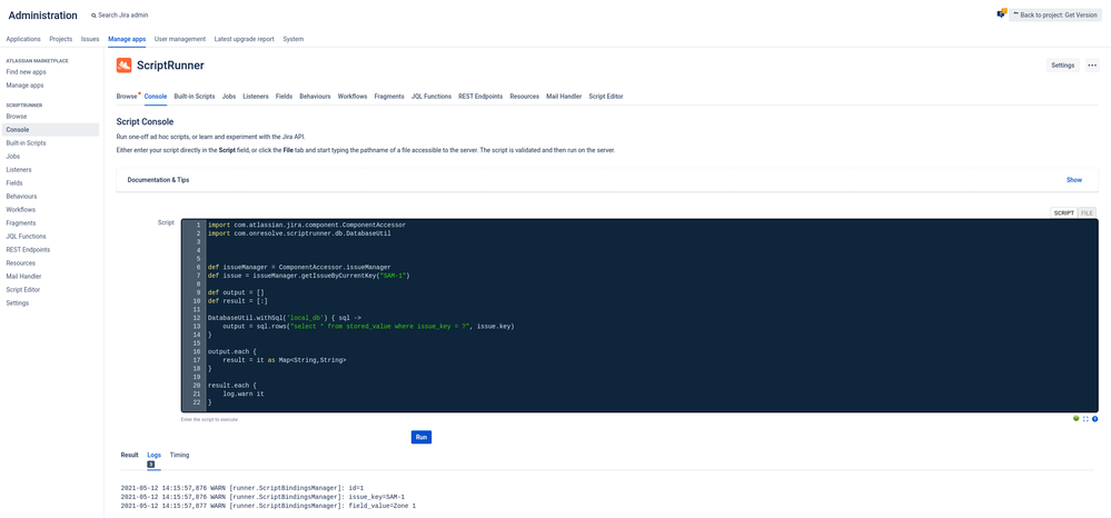

The local_db used in the code above refers to the Local Database connection shown below:-
Below is a print screen of the output:-
I hope this helps to answer your question. :)

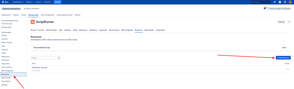

To answer your question, yes,  you will first need to set up a connection to your Local Database, i.e. the database your Jira instance is connected to using ScriptRunner's Resources.
Looking at the configuration print screen that you have shared in your previous comment, it appears that you have already configured it. And, have you saved the Local Database configuration?
First, go to ScriptRunner's Resources and setup and Local Database connection as shown below:-

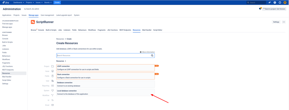

Once you have selected Create Resources, select Local Database connection as shown below:-

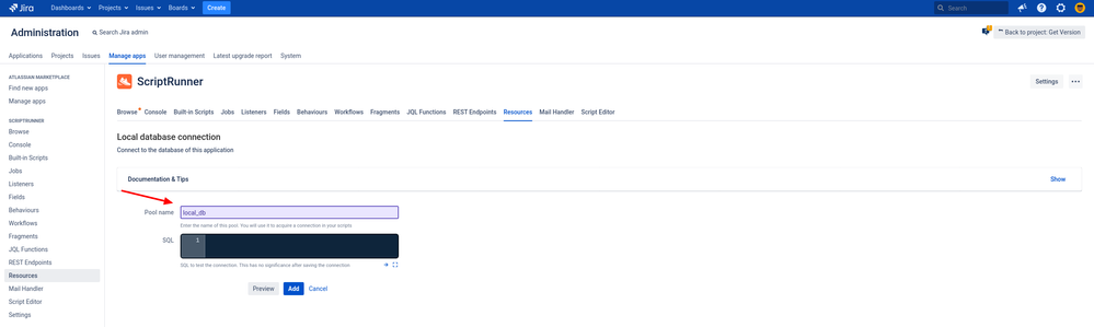

Next, enter the name you want to use for the Local Database connection and save it.
In the print screen above, the Local Database name set is local_db. This is the same name that is used in the DatabaseUtil.withSql shown in the sample code below.

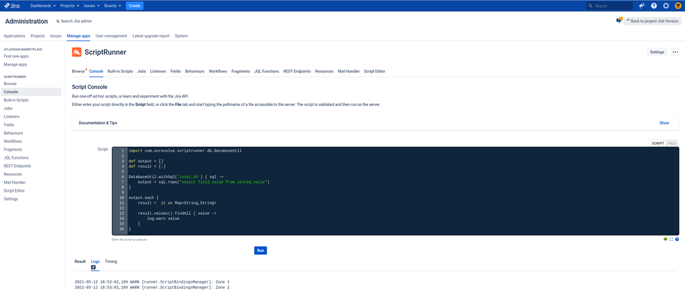

So in this, it should print all the values. Below is the test result:-
result.pngIf you notice in the image above, the results are now displayed in new lines.
