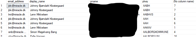

Casper Hjorth Christensen
October 24, 2019
That works - Thanks
a little BUT, nearly each line is doubled, shown by the project key.
We are currently using a Microsoft SQL 2012 server... :S
Unfortunately i'm not an DB admin or SQL sysadmin - due to my lack of knowledge with SQL, i've asked not to have these rights..
But as i'm unable to run the first query provided, i would say "Yes, ONLY_FULL_GROUP_BY is enabled"
----- EDIT -----
Oh - And how do I get a name for the last column? easier to call a column when its named ;)

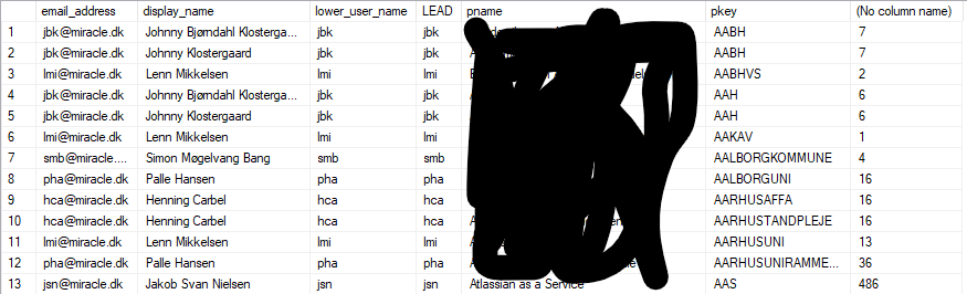

can you  try this so we can see the username of the LEAD of every project,
SELECT us.email_address, us.display_name, us.lower_user_name, pr.LEAD, pr.pname, pr.pkey, count(ji.id)
FROM jiraissue ji
left join project pr on pr.id = ji.project
left join cwd_user us on us.lower_user_name = pr.LEAD
group by pr.pkey, us.email_address, us.display_name, pr.pname,us.lower_user_name, pr.LEAD;
October 24, 2019
Here you go :)
Fran Garcia
October 24, 2019
seems like you have Johnny Klostergaard twice in the database, with different display_name but with the same user_name (jbk) and the same email (jbk@...)
the query is going to give you one row for every matching lower_user_name.
I think you should solve that by deleting the duplicates or you can just get the first one using MIN(display_name) or MAX(display_name to get only one row per project.
Something like this should do the work (can't test it because i don't have duplicates).
SELECT us.email_address, MAX(us.display_name), us.lower_user_name, pr.LEAD, pr.pname, pr.pkey, count(ji.id)
FROM jiraissue ji
group by pr.pkey, us.email_address, pr.pname,us.lower_user_name, pr.LEAD;
probably there is a fancier way to do the SQL, but i think the idea is there
October 24, 2019
My "User Management" interface in JIRA, only shows him once.. dont know why there would be two.
That seemed to solve it - Thanks a bunch!

#ExportSQLtoExcel.ps1
#some variables
$serverName = "<SQL Server Name>"; # Fill in with the SQL Server Name
$databaseName = "'<JIRA DATABASE>'"; # Fill in with the desired JIRA database to run this extract against.
#the save location for the new Excel file
$filepath = "C:\temp\Project-Statistics.xlsx";
# Check if file exist, if it does, delete it
# File contains previous output of Project Statistics
$file = "C:\temp\Project-Statistics.xlsx"
If(test-path $file)
Remove-Item -Path $file -Recurse
#create excel object
$excel = New-Object -ComObject Excel.Application
$workbook = $excel.Workbooks.add()
$worksheetA = $workbook.Worksheets.Add()
#create byUser worksheet
$sheet1 = $workbook.worksheets.Item(1)
$sheet1.name = "Project-Statistics"
#create a Dataset to store the DataTable
$dataSet = new-object "System.Data.DataSet" "Project-Statistics"
#create a Connection to the SQL Server database
$cn = new-object System.Data.SqlClient.SqlConnection "server=$serverName;database=$databaseName;Integrated Security=sspi"
$query= "SELECT us.email_address, MAX(us.display_name)Lead_Display_Name, us.lower_user_name, pr.LEAD, pr.pname, pr.pkey, count(ji.id)Issue_Count FROM jiraissue ji left join project pr on pr.id = ji.project left join cwd_user us on us.lower_user_name = pr.LEAD group by pr.pkey, us.email_address, pr.pname,us.lower_user_name, pr.LEAD;"
#Create a SQL Data Adapter to place the resultset into the DataSet
$dataAdapter = new-object "System.Data.SqlClient.SqlDataAdapter" ($query, $cn)
$dataAdapter.Fill($dataSet) | Out-Null
#close the connection
$cn.Close()
$dataTable = new-object "System.Data.DataTable" "Principals"
$dataTable = $dataSet.Tables[0]
#assign column names
$sheet1.cells.item(1, 1) = "Lead Email"
$sheet1.cells.item(1, 2) = "Lead Display Name"
$sheet1.cells.item(1, 3) = "Lead Username Lower Case"
$sheet1.cells.item(1, 4) = "Lead Username"
$sheet1.cells.item(1, 5) = "Project Name"
$sheet1.cells.item(1, 6) = "Project Key"
$sheet1.cells.item(1, 7) = "Issue Count"
#iterate through every DataTable line item and insert to the Excel worksheete
##Note: starts at 2 as 1 is the column headers
$x=2
$dataTable | FOREACH-OBJECT{
$sheet1.cells.item($x, 1) = $_.email_address
$sheet1.cells.item($x, 2) = $_.Lead_Display_Name
$sheet1.cells.item($x, 3) = $_.lower_user_name
$sheet1.cells.item($x, 4) = $_.LEAD
$sheet1.cells.item($x, 5) = $_.pname
$sheet1.cells.item($x, 6) = $_.pkey
$sheet1.cells.item($x, 7) = $_.Issue_Count
$x++
$range1 = $sheet1.UsedRange
$range1.EntireColumn.AutoFit()
#save excel worksbook
$excel.ActiveWorkbook.SaveAs("$filepath ")
$excel.quit()
