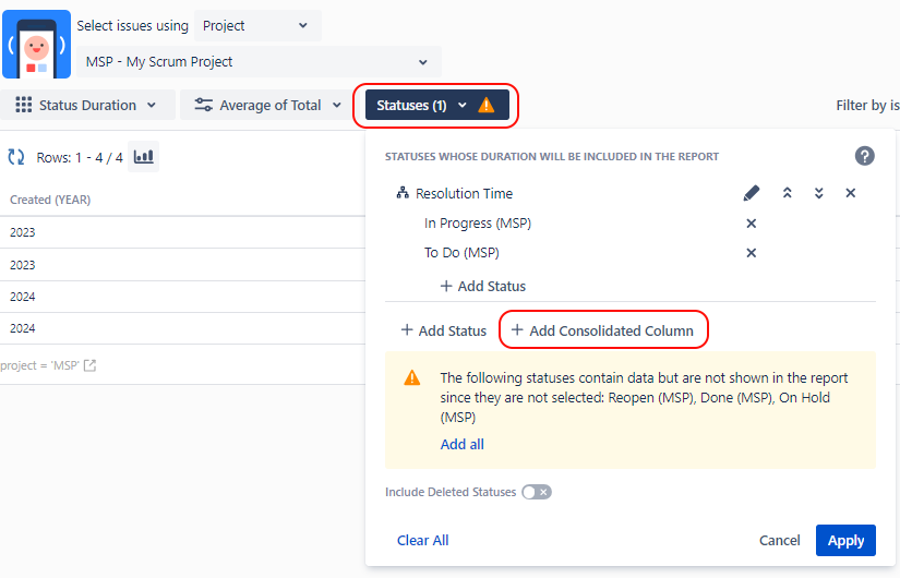

You can also use Consolidated Columns to group statuses into SLA metrics like "Response Time" or "Resolution Time", and monitor them across all issues.

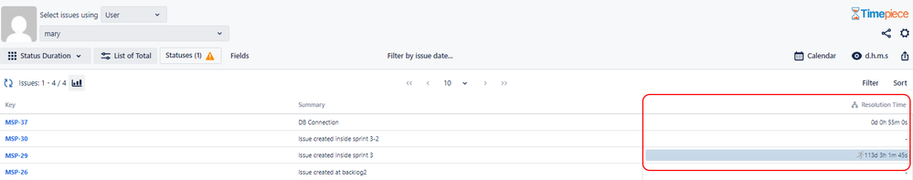

To make SLA breaches more visible, you can use the Highlight feature to define visual thresholds such as:
  •  Resolution Time ≥ 10 days
  •  Resolution Time ≥ 7 days
  •  Response Time ≥ 2 days

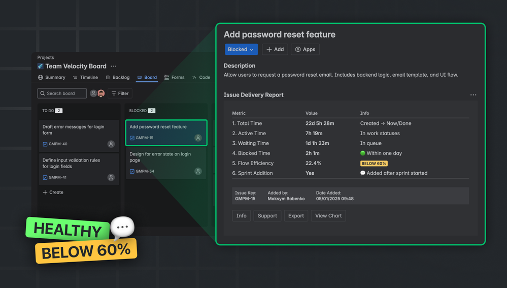

Maksym Babenko_TypeSwitch_
Atlassian Partner
May 29, 2025
Hi @Raunak Maskay
We had a similar challenge in our team with internal SLAs inside Jira Software (not JSM).
You might want to try the Issue Delivery Report app it’s a lightweight tool that shows:
  • Time spent in each status
  • Total turnaround time
  • Flow Efficiency
  • Late sprint additions and warnings if flow is inefficient
It runs directly in the Jira issue view and uses full changelog to calculate timing, so no custom fields or automation required.
Here's the link if you'd like to try it:
🔗 https://marketplace.atlassian.com/apps/1238016
I hope this message is useful and will help you!

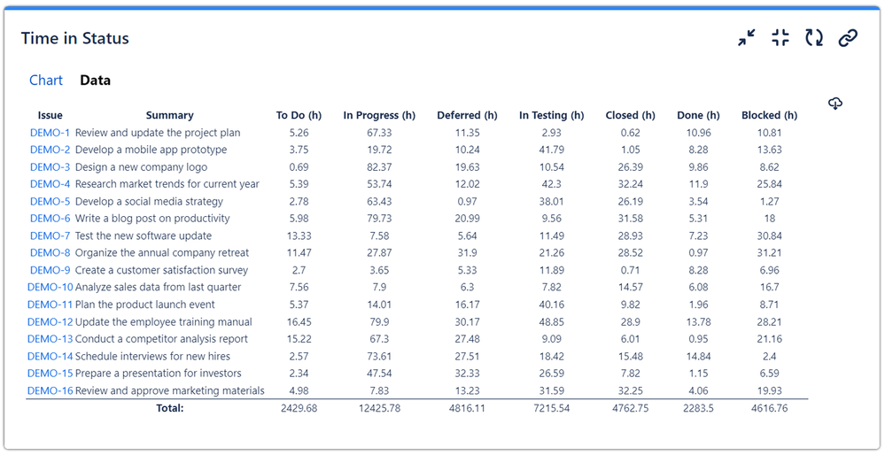

Time in Status gadget - allows you to visualize the (total or average) time in status for the issues in a filter/JQL.
The gadget displays a Data tab with detailed info for every issue.
So this will gadget will cover your "time spent in each lane/status" requirement.
