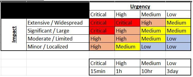

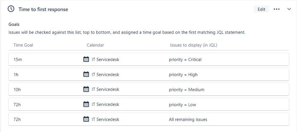

This depends on how you setup your Time Goals on the SLA. In our company our Time to First Response is defined by the Priority set on the ticket. Below is how we setup ours. The higher the priority the shorter the time goal.
We define the Priority of a ticket by what is selected in the Impact and Urgency Fields. Basically we are using a priority matrix to define this.
I'm trying not to go into too much further detail as it may be irrelevant to your situation (happy to explain further though if you like), but I have automated the Impact and Urgency fields based on the "Operational Categorization" selected on the ticket. For example, Server down is Critical Priority. Server Performance might be High Priority though. Requesting access to a mailbox is Low.
So for us, we set the Operational Categorization on the ticket when we assign it. This automatically defines the Impact and Urgency Fields which then automatically defines the Priority field (all done by Automation Rules). The assignee still has the ability to change the Impact or Urgency fields if they feel it needs to be higher or lower for the situation.
2. Yes. If you want the time to resolution to be 5 days then you would enter 120h as the time goal.
