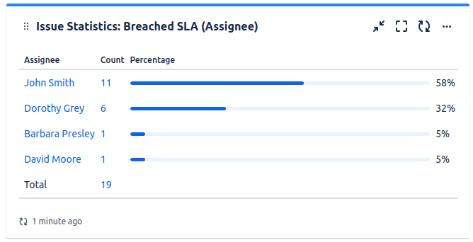

Hi @Trenton Finley,
I don't think is possible to extend that report to split data by users.
Be aware that there are some JQL queries that you can use to determine the issue with breached SLA or meet SLA.
Breached SLA issues
"Time to resolution" = breached()
Meet SLA issues
"Time to resolution" != breached()
If you save these 2 queries as filters, you could then use the Issue Statistics gadget to display the stats by Assignee. Unfortunately you cannot display them both in one gadget; so will need two gadgets: one for Breached SLA, one for Meet SLA.
Danut

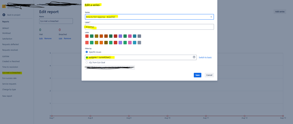

My apologies, but I mean that I would like to see the SLAs meet and breached per user.
You would need to create reports like SLA met vs breached then add a filter in the series.
example: assignee = currentUser() - this will get the sla of the current user who is viewing the report.
But if you like to align your users in 1 report. You can create separate report for SLA met and breached. Where you can add a series per assignee
example: assignee = User1
Thanks!
