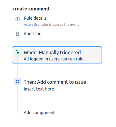

Hi,

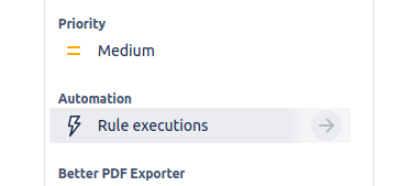

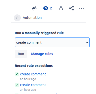

I had a similar request and maybe it helps you. We wanted to implement shortcut buttons that send out different comments when used. By using several transitions to the state itself you get the Actions Menu as Benjamin Peikes already mentioned. However differentiating the transition was my problem as well. I tried Edgar Kellermann's solution with the generic event but could not solve the last part in the automation.
The current solution we use is making for each Button/Transition, as in the actions menu, an automation rule that posts e.g., wished comment directly on the issue and the trigger is the Manual trigger. In the Issue View under Automations you can select wished automation to the thing you want (in my case it's a comment, could be also a transition,... you name it). The manual trigger can also restrict which user groups can trigger this automation
cheers
