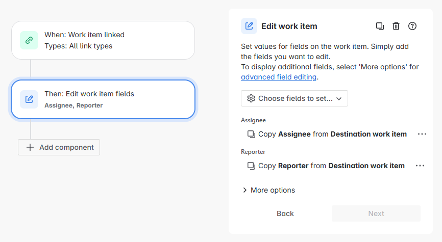

Configure this using the destination work item to copy from A to B (push data). Here’s the configuration I used that worked for me:
This reversed perspective on “source” and “destination” might save some head-scratching if your setup isn’t behaving as expected.

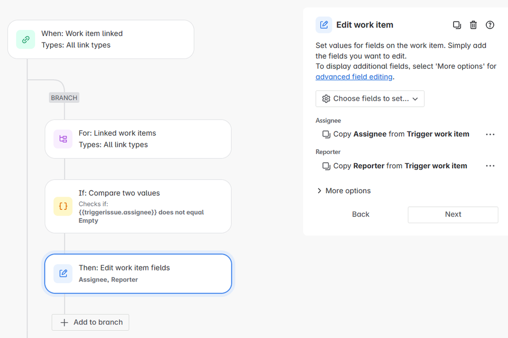

Hi @Jeffrey Li ,
Change the condition to a smart value condition:
{{triggerissue.assignee}} is not empty
Then in the Edit section select assignee and reporter in one action and add copy from trigger work item, see picture below

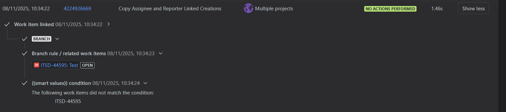

@Jeffrey Li, if this is not working as expected, would you mind sharing the audit log when the rule is executed?
Jeffrey Li
August 11, 2025
I tried making the change and this didnt work either. Log shows that "No Actions Performed", below are the details.
The trigger event Assignee is populated with my name, so it is definitely not empty.

To copy from A to B in this case (or to 'push' the information), I used this configuration with the destination work item:
Does this help?
Jeffrey Li
August 11, 2025
Yes, exactly this! @Thorsten Letschert _Decadis AG_ It defies logic that the newly created item is actually the trigger ticket rather than the destination ticket.
Thanks for helping!

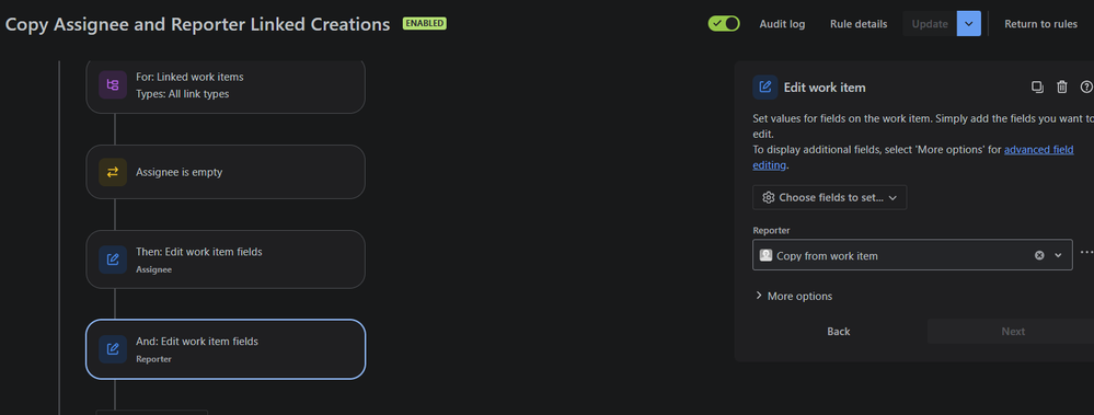

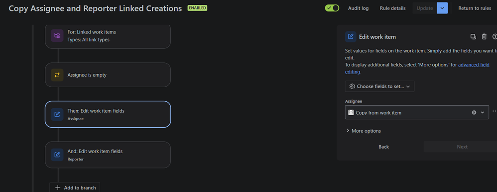

I have edit issues in all the projects.

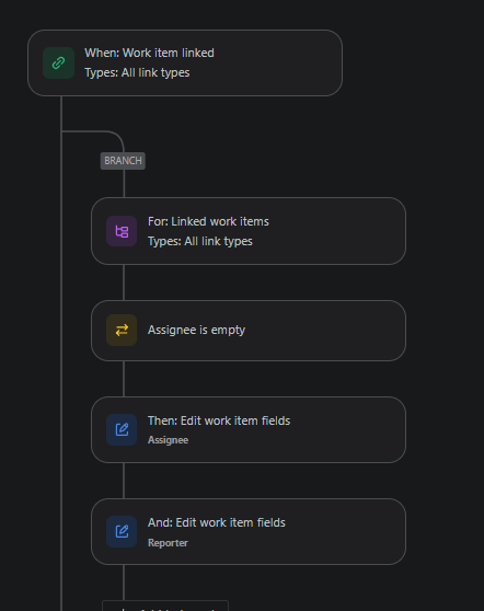

Jeffrey Li
August 11, 2025
I've tried copy from trigger work event as the option as well, and its the same result.
