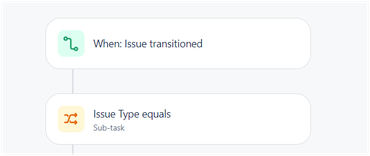

@Sameeksha Shetty You may have to use two automations to achieve this.
One for Transitioning Story based on Sub-Task and the other for transitioning Epic based on the Story.
You may use the trigger - When issue transitioned
Check if the transitioned issue is Sub-task using an Issue Type condition

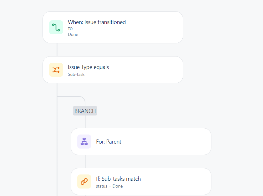

Add a branching for Parent and check if Sub-Task status match Done/Complete using a Related Issue condition.

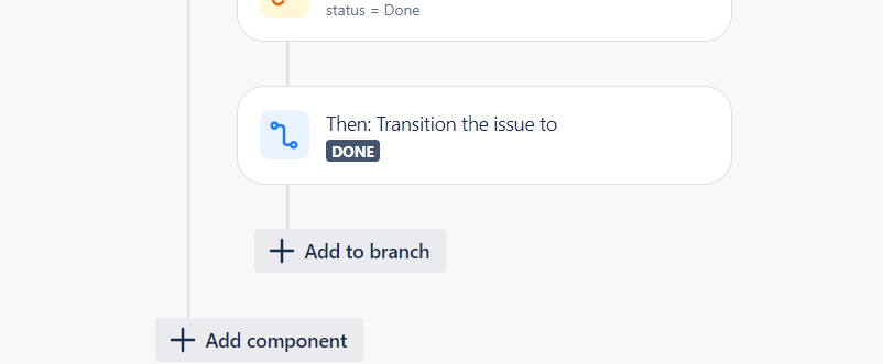

And finally finally transition the Parent (story) to Done if above condition is true.
Similarly, you can do for Story-Epic status change.
