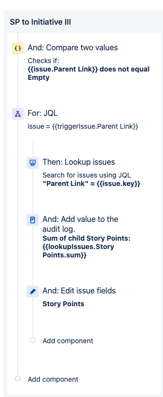

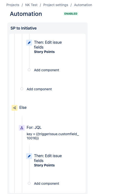

This is a snapshot of formula:

According to the log the rule was triggered for issue NKT-5, and that issue failed to meet the first condition - issue type = Epic. Therefore the rule did not proceed.
If the summaries shown for the issues in your other image are accurately noting the summary type, the NKT-5 is a Story type of issue. The only issue from that image that is both an Epic and has a Parent Link value is NKT-2.

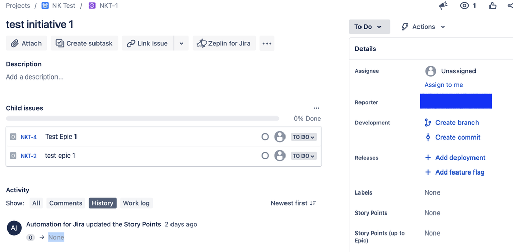

According to automation log field should be updated.
But for some reason it doesnt update the field with expected number. It updates it to "None"
May I kindly ask your advice here as well?

I have set up the same rule in a test project, and it works for me.
Can you show us the details of the Edit Issue step, so I can check it for any potential typos?
Sometimes Automation Rules can get glitchy if they have been edited a lot. If there are no typos in the Edit Issue step, that I suggest that you try making the rule again from scratch? Disable this first version, make a new rule with the same steps and enable it, and then try changing the story points of the Epics. Let us know if the rule succeeds in updating the Initiative.

Thank you very much for your advice - to check the "Edit" Issue step.
It was typo there. That is the reason why rule was executed, but field was updated with "None" :)
