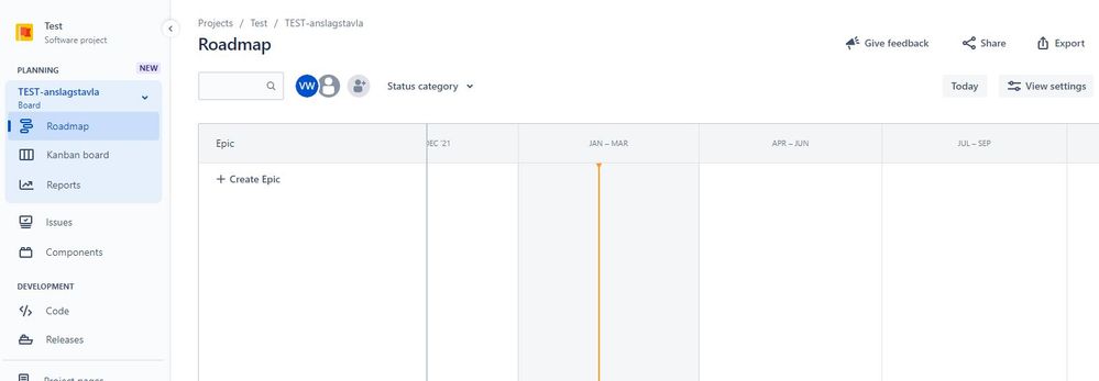

Hi
I have create a two new issue type, feature and sub feature. Now I would like to create a Roadmap with only feature and sub features. I have search to forum and haven't found what I want to do. So I would like to change Epic to mya new issue types (Feature and sub feature)

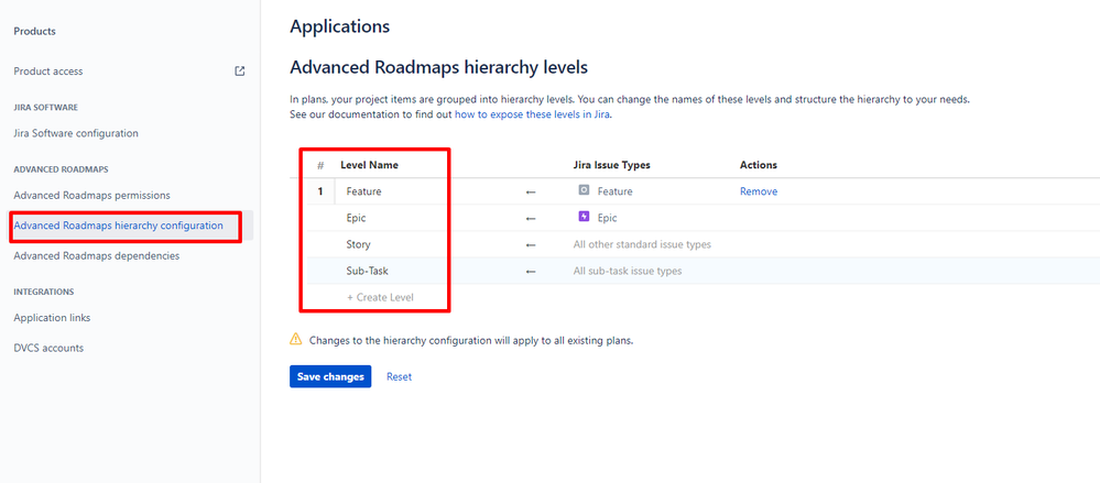

One thing you can do it as you can introduce Feature as new Issue type
which will link to Epic
Feature > Epic > Story > Subtask
Here Feature ( Vision from One project) will link to Epic of another Project ( Development). Here you can add more level above feature in future if you want to add.
You can configure and see that in the Roadmap as well  like this. Same hierarchy will be display in the plan
