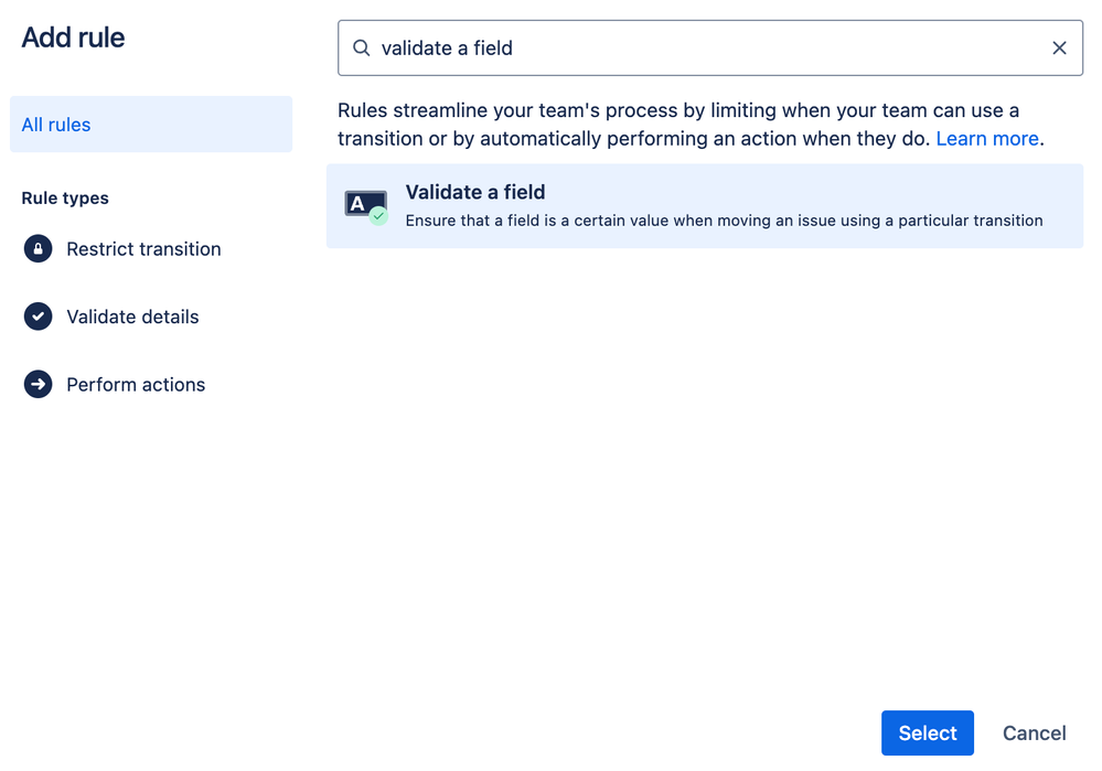

This can be achieved in a pretty easy way:

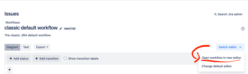

  2. OPTIONAL: If you are not using the new workflow editor yet (you probably are, as it is default), make sure you do, as it is more user-friendly! :)

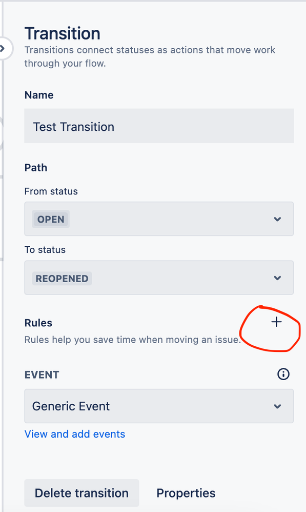

  3. Click on the transition that you are interested in (you do not have to limit yourself to only one transition), and click on the + button on the right context menu.

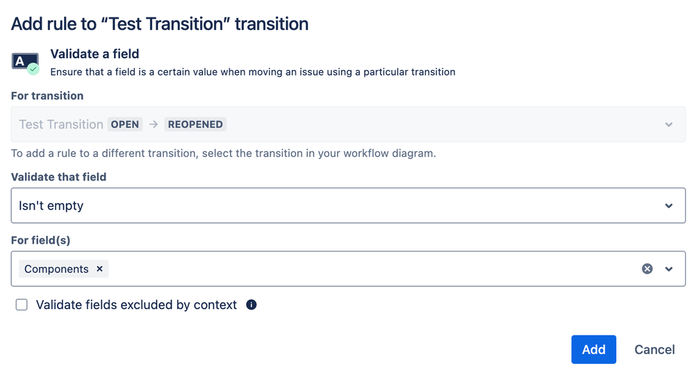

  4. Use the "Validate a field" option.
  5. Select the field you are interested in in the "For field(s)" part.
  6. In the "Validate that field", depending on your needs, you might choose "Isn't empty" value.

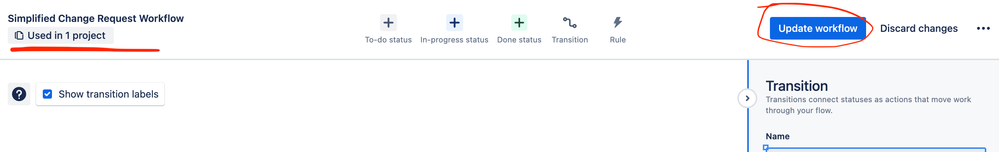

  8. When done, on the Workflow overview, make sure that if the workflow is already used, you really want to introduce that change to all affected projects. Clicking on "Used by X project(s)" will show all projects that will be impacted by any change.
  9. When sure that you want to proceed, click on "Update workflow" button.

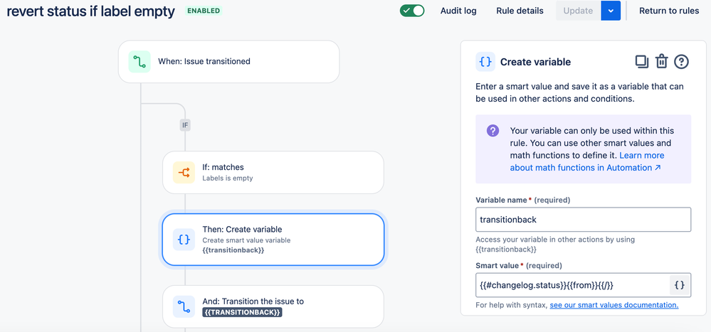

Noted! In this case, if you really want to go for the Jira Automation, you could achieve it this way.
  1. After you setup initial conditions for this Jira Automation (trigger/when to execute the rule, what issuetype you want to look for and so on), add "IF: Add a condition" and select "IF or ELSE: Add condition options" from the follow up.
  2. Then, inside that IF branch, add component "THEN: Add an action" and pick "Create variable":
    1. Variable name: transitionback
    2. Smart value: {{#changelog.status}}{{from}}{{/}}

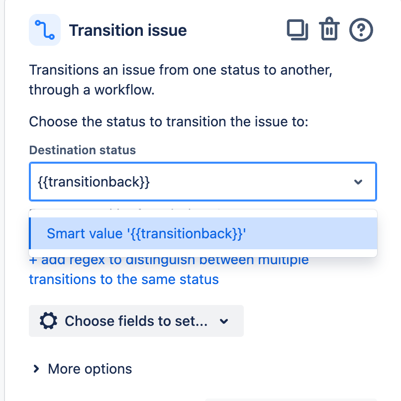

  3. Then, below, add component "THEN: Add an action" and pick "Transition issue":
    1. Destination status: {{transitionback}}
      Just start writing it, and then pick the drop down that activates smart value.
  4. Add whatever else you want after that, e.g., send an email, add a comment or whatever else. :)
This is how the automation looks on my end, perhaps not the most performance-friendly approach, but it should work just fine.
IMPORTANT:
Please remember that a transition back must be enabled/possible! If the Workflow does not allow it, it will fail.
