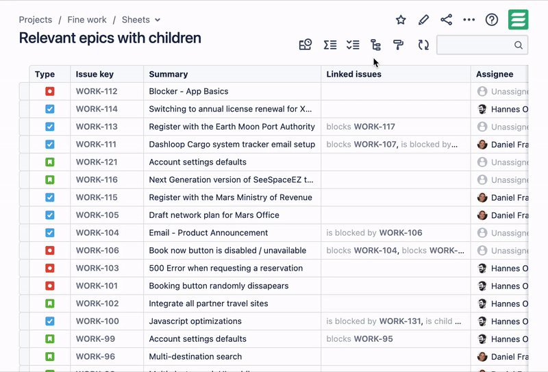

just to add to Rik's answer, if you're open to solutions from the Atlassian Marketplace, another option would be to look into the more hierarchy-focused apps. These apps typically have their own, more powerful ways to sort out parent/child relationships, and therefore give you more freedom in navigating through issue hierarchies.
I can only speak for the app that my team is working on - JXL for Jira - but here, your use case should be easy to solve:
Happy to elaborate on the exact steps - but as you can see, it's really just a number of clicks. Once you got your set of issues, you can work on them directly in the app, trigger various operations in Jira, or export them for further processing.
As noted above, there's actually a number of apps that might solve your problems - by extending JQL, or by making it easier to work with issue hierarchies. You may already know that you can trial any app for free for 1 month, and depending on the size of your site, an app may be free forever; so if an app is an option for you, perhaps try out a few and see which one works best for you.
