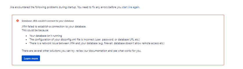

2020-04-18 21:27:01,965 Caesium-1-1 ERROR ServiceRunner [c.a.s.caesium.impl.SchedulerQueueWorker] Unhandled exception thrown by job QueuedJob[jobId=CaesiumSchedulerService.RecoveryJob,deadline=1587259621954]
JIRA/server get's bounced....
2020-04-18 21:41:26,051 JIRA-Bootstrap INFO [c.a.j.config.database.SystemDatabaseConfigurationLoader] Reading database configuration from /apps/jirahome/dbconfig.xml
2020-04-18 21:41:26,445 JIRA-Bootstrap ERROR [c.a.config.bootstrap.DefaultAtlassianBootstrapManager] Could not successfully test your database:
java.sql.SQLRecoverableException: IO Error: The Network Adapter could not establish the connection
at oracle.jdbc.driver.T4CConnection.logon(T4CConnection.java:774)
at oracle.jdbc.driver.PhysicalConnection.connect(PhysicalConnection.java:688)
at oracle.jdbc.driver.T4CDriverExtension.getConnection(T4CDriverExtension.java:39)
at oracle.jdbc.driver.OracleDriver.connect(OracleDriver.java:691)
at java.sql.DriverManager.getConnection(DriverManager.java:664)
at java.sql.DriverManager.getConnection(DriverManager.java:247)
at com.atlassian.config.bootstrap.DefaultAtlassianBootstrapManager.getTestDatabaseConnection(DefaultAtlassianBootstrapManager.java:347)
at com.atlassian.jira.config.database.JdbcDatasource.getConnection(JdbcDatasource.java:211)
at com.atlassian.jira.config.database.DatabaseConfig.testConnection(DatabaseConfig.java:88)
at com.atlassian.jira.health.checks.DbConfigurationAndConnectionCheck.doPerform(DbConfigurationAndConnectionCheck.java:60)
at com.atlassian.jira.health.HealthCheckTemplate.perform(HealthCheckTemplate.java:23)
at com.atlassian.jira.health.DefaultHealthCheckExecutor.runCheck(DefaultHealthCheckExecutor.java:74)
at com.atlassian.jira.health.DefaultHealthCheckExecutor.lambda$applyAndCollectExceptions$1(DefaultHealthCheckExecutor.java:53)
at java.util.stream.ForEachOps$ForEachOp$OfRef.accept(ForEachOps.java:184)
at java.util.stream.ReferencePipeline$2$1.accept(ReferencePipeline.java:175)
at java.util.Iterator.forEachRemaining(Iterator.java:116)
at java.util.Spliterators$IteratorSpliterator.forEachRemaining(Spliterators.java:1801)
at java.util.stream.AbstractPipeline.copyInto(AbstractPipeline.java:481)
at java.util.stream.AbstractPipeline.wrapAndCopyInto(AbstractPipeline.java:471)
2020-04-18 21:41:26,462 JIRA-Bootstrap ERROR [c.a.jira.health.HealthChecks] JIRA couldn't connect to your database
2020-04-18 21:41:26,462 JIRA-Bootstrap ERROR [c.a.jira.health.HealthChecks] JIRA failed to establish a connection to your database.
This could be because:
- Your database isn't running
- The configuration of your dbconfig.xml file is incorrect (user, password, or database URL etc.)
- There is a network issue between JIRA and your database (e.g. firewall, database doesn't allow remote access etc.)
There are several other solutions you can try, review our documentation and see what works for you.
2020-04-18 21:41:26,465 JIRA-Bootstrap INFO [c.a.jira.startup.JiraStartupLogger] Running JIRA startup checks.
2020-04-18 21:41:26,465 JIRA-Bootstrap FATAL [c.a.jira.startup.JiraStartupLogger] Startup check failed. JIRA will be locked.
Then we reboot it again after DB is up and it works.  If JIRA can't self recover than I guess our script will use to start JIRA will need to be enhanced to check the status of the DB and not come up until the DB is able to connect.
