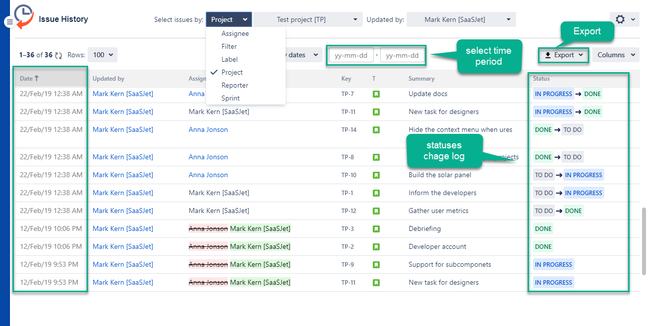

Hi @José Agnaldo B_ de Sousa
You can consider add-on Issue History. It will let you view all issues which had changed statuses. To filter data only by two statuses you need, you can use export and then "play" with data at Microsoft Excel or Google Spreadsheet. I don't sure that it is what you need, but if you haven't other solutions, you can try it.
