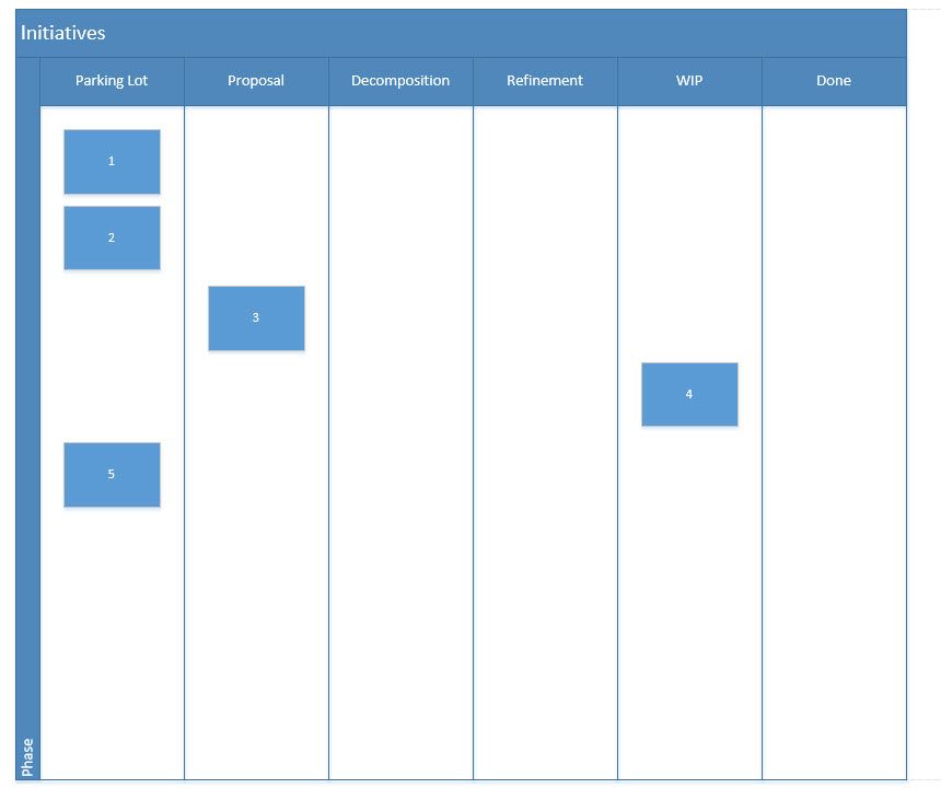

While using the Kanban board for the Epics, whenever I move an Epic to a new column, it doesn't maintain the overall prioritization of the Epics.  In the example I gave above, it'd be beneficial if the Epic was in our WIP column but 5 card spaces down (regardless if there are any other cards in that column or not).   This way we can continue to see the prioritization of the work as it is moving through our process pipeline.  See attached mockup for what I have pictured in my head.
Initiatives.jpgIs this possible with Jira today?

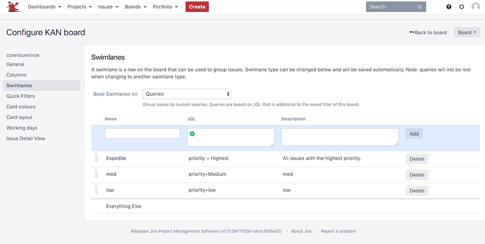

First I went into the board config and set the swimlanes to be based off Queries.  Then I created a query for the different priority levels:

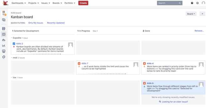

With this in place, returning to the boards looks like this:
You can see that the cards will maintain their vertical position within their swimlane.   So this might help.  I could understand that this might be less than helpful if you were wanting to use the issue's Rank value in this manner.  However Rank is not a clearly set value on issues, the value issues have in Rank is not static either.  Instead the Rank value for each issue is relative to all the other issues in Jira, so it's not an ideal candidate for the kind of view I think you are wanting to setup here.
But I think that the swimlanes could help you view the board in a similar way.
