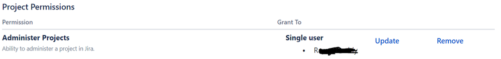

I've removed Administrator for the below Permission and added single user, however Admins are able to still access the Project settings. Is this a bug?

When you say "Admins" can still access the project settings, do you mean users assigned to the Administrator role for just that project, or do you mean users granted the Administer Jira Global Permission?
Radhakrishnan B
May 3, 2023
I'm referring the site administrator with Global Permission can still access the project. I've removed them from a specific project in the project settings to keep it private for specific users.
