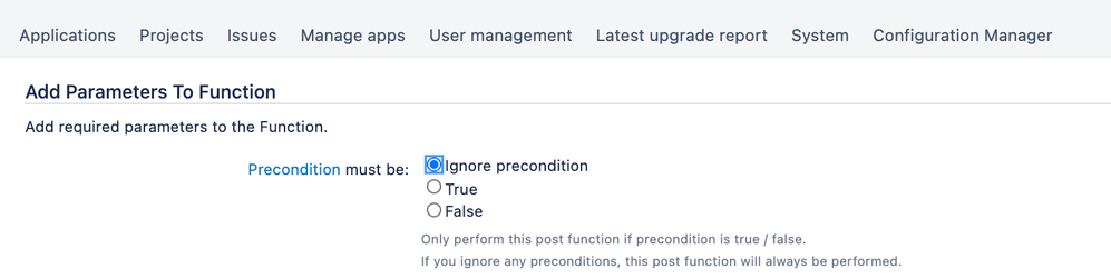

Ramya Yarru
February 12, 2021
Yes @Manuel Galván
Please find the attached screenshot.

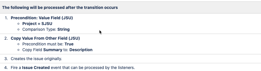

Deleted user
February 15, 2021
Hi @Ramya Yarru ,
Have you tried using the Value in Field Precondition. Please see a simple example as shown below Precondition.png
The above precondition will check if you are creating the issue in the project SJSU and then only execute the postfunction.
We have also internally created a support request in our portal for the same if you need any further help.

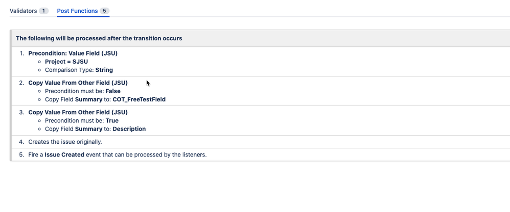

Deleted user
February 15, 2021
Hi @Ramya Yarru ,
You can use precondition with postfunction similar to the one shown below
As per the above screenshot if the Project is SJSU then the summary field will be copied to description. If you try for other projects lets say test then the summary field will be copied to the custom text field.

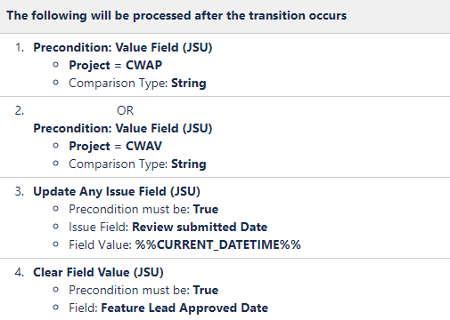

Ramya Yarru
February 16, 2021
@[deleted] PFA, I have 2 preconditions and both should be applied to both post functions. Is the above approach fine or should I defined Step 1 and 2 again for Step 4 (clear Field value). As of now it works but I just want to get confirmation on correct procedure.
Deleted user
February 17, 2021
Hi @Ramya Yarru
Yes the way you have configured should work for both CWAP and CWAV projects.
Please let us know if you need any further information .
Regards,
Vijay Ramamurthy

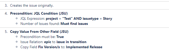

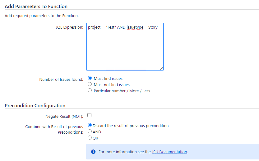

Ramya Yarru
February 12, 2021
Hello @Manuel Galván  Thank you for your answer.
I have used a precondition and set the precondition to true on my post function but that did not work and effected all other projects associated to workflow.
Please find the attached screenshot on pre-condition
