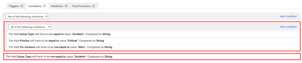

You can achieve this using conditional branches.
Set up a condition that hides the transition from the user if the required criteria are not met.
Here’s an example:

Thanks, this is how i set it up before

I'm not entirely sure I’ve understood the issue correctly — some screenshots of your configured conditions and validators would help clarify. But based on the information provided, here are my thoughts:
  • You can use separate workflows for different issue types. This way, changes to one issue type won't affect others.
  • Your setup sounds similar to the example I added above — where a transition is shown only if, for instance, the issue is an Incident with Critical priority, or the issue type is not Incident .
  • You can also add validators, but be cautious — if one issue type has certain fields and another doesn’t, it may cause issues with the transition. That’s why using separate workflows per issue type is usually the better approach.
